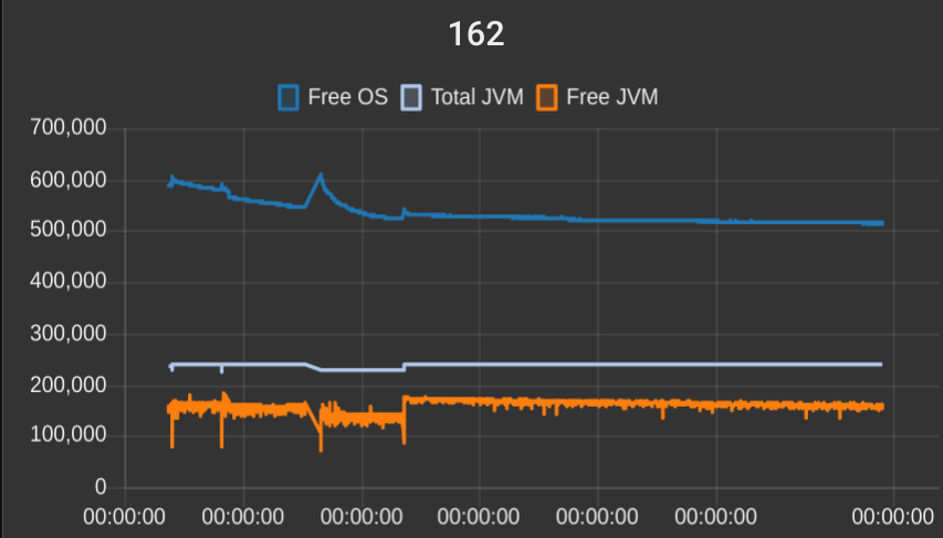

Date/time,Free OS,Total JVM,Free JVM
2020-12-09 18:00:34,612740,222848,59005
2020-12-09 18:05:39,591560,241576,122973
2020-12-09 18:10:49,589564,241576,132603
2020-12-09 18:15:57,587348,241576,160809
2020-12-09 18:21:01,585840,241576,140826
2020-12-09 18:26:18,575564,241576,98405
2020-12-09 18:31:35,573212,241576,102598
2020-12-09 18:36:50,571656,241576,112083
2020-12-09 18:42:08,569540,241576,143020
2020-12-09 18:47:22,566492,241576,122504
2020-12-09 18:52:31,565844,241576,113873
2020-12-09 18:57:43,565272,241576,101463
2020-12-09 19:02:58,564140,241576,101795
2020-12-09 19:08:13,564448,241576,130908
2020-12-09 19:13:32,562596,241576,138614
2020-12-09 19:18:42,562112,241576,126145
2020-12-09 19:24:01,557028,241576,93092
2020-12-09 19:29:16,555156,241576,112487
2020-12-09 19:34:26,556576,241576,149966
2020-12-09 19:39:40,556048,241576,143326
2020-12-09 19:44:56,555504,241576,125456
2020-12-09 19:50:11,555124,241576,132154
2020-12-09 19:55:25,555652,241576,151666
2020-12-09 20:00:33,553720,241576,121014
2020-12-09 20:05:48,553564,241576,109265
2020-12-09 20:11:08,552244,241576,113886
2020-12-09 20:16:22,552456,241576,91682
2020-12-09 20:21:42,551972,241576,127398
2020-12-09 20:26:56,552032,241576,126641
2020-12-09 20:32:12,548848,241576,148066
2020-12-09 20:37:21,545352,241576,152103
2020-12-09 20:42:41,545128,241576,138324
2020-12-09 20:47:56,542360,241576,119105
2020-12-09 20:53:16,542032,241576,120436
2020-12-09 20:58:36,541556,241576,112687
2020-12-09 21:03:56,541020,241576,117075
2020-12-09 21:09:06,539264,241576,123260
2020-12-09 21:14:15,538804,241576,127672
2020-12-09 21:19:35,535860,241576,124373
2020-12-09 21:24:55,535528,241576,115502
2020-12-09 21:30:10,534736,241576,131195
2020-12-09 21:35:30,534260,241576,127029
2020-12-09 21:40:45,533056,241576,94357
2020-12-09 21:46:05,533232,241576,110832
2020-12-09 21:51:25,531420,241576,103627
2020-12-09 21:56:40,530624,241576,101867
2020-12-09 22:01:49,528988,241576,95511
2020-12-09 22:07:09,528684,241576,115772
2020-12-09 22:12:29,528204,241576,133598
2020-12-09 22:17:50,527464,241576,132040
2020-12-09 22:23:10,527192,241576,111336
2020-12-09 22:28:30,524240,241576,105062
2020-12-09 22:33:45,523756,241576,108692
2020-12-09 22:39:05,521292,241576,136921
2020-12-09 22:44:25,519132,241576,128512
2020-12-09 22:49:40,518208,241576,147447
2020-12-09 22:54:59,517832,241576,134903
2020-12-09 23:00:12,515816,241576,120198
2020-12-09 23:05:27,515040,241576,106036
2020-12-09 23:10:47,514348,241576,124143
2020-12-09 23:16:07,513580,241576,116536
2020-12-09 23:21:22,512828,241576,128442
2020-12-09 23:26:42,512208,241576,121346
2020-12-09 23:31:52,512548,241576,140629
2020-12-09 23:37:01,511612,241576,129773
2020-12-09 23:42:21,510784,241576,107821
2020-12-09 23:47:31,509568,241576,114831
2020-12-09 23:52:51,508968,241576,97585
2020-12-09 23:58:06,505648,241576,125356
2020-12-10 00:03:21,505752,241576,136682
2020-12-10 00:08:41,504820,241576,111279
2020-12-10 00:14:01,504624,241576,133522
2020-12-10 00:19:22,504420,241576,126744
2020-12-10 00:24:41,502380,241576,130065
2020-12-10 00:29:51,501472,241576,127491
2020-12-10 00:35:06,500824,241576,100559
2020-12-10 00:40:26,500284,241576,104985
2020-12-10 00:45:41,499856,241576,141110
2020-12-10 00:51:01,498588,241576,130979
2020-12-10 00:56:16,498716,241576,123925
2020-12-10 01:01:31,496768,241576,127328
2020-12-10 01:06:46,496116,241576,120497
2020-12-10 01:11:56,495760,241576,134464
2020-12-10 01:17:11,496480,241576,111285
2020-12-10 01:22:26,495240,241576,110518
2020-12-10 01:27:46,494528,241576,104109
2020-12-10 01:33:06,494240,241576,113180
2020-12-10 01:38:26,491572,241576,125258
2020-12-10 01:43:46,491248,241576,126262
2020-12-10 01:49:01,491192,241576,125402
2020-12-10 01:54:21,491600,241576,136324
2020-12-10 01:59:42,489556,241576,108246
2020-12-10 02:05:02,489472,241576,100069
2020-12-10 02:10:12,489496,241576,121941
2020-12-10 02:15:21,487548,241576,113436
2020-12-10 02:20:42,486504,241576,113025
2020-12-10 02:26:02,485740,241576,110511
2020-12-10 02:31:17,485112,241576,90751
2020-12-10 02:36:37,485792,241576,123018
2020-12-10 02:41:57,485280,241576,116988
2020-12-10 02:47:17,485156,241576,102496
2020-12-10 02:52:39,484168,241576,107336
2020-12-10 02:57:59,483412,241576,101080
2020-12-10 03:03:19,483064,241576,102157
2020-12-10 03:08:40,483240,241576,109270
2020-12-10 03:13:58,482404,241576,124271
2020-12-10 03:19:18,482232,241576,121036
2020-12-10 03:24:33,481796,241576,108461
2020-12-10 03:29:48,481724,241576,118390
2020-12-10 03:35:08,481620,241576,97397
2020-12-10 03:40:29,481212,241576,93903
2020-12-10 03:45:49,480160,241576,99976
2020-12-10 03:51:04,480308,241576,134298
2020-12-10 03:56:24,479784,241576,116074
2020-12-10 04:01:40,477484,241576,124034
2020-12-10 04:07:00,476792,241576,116308
2020-12-10 04:12:20,476832,241576,94083
2020-12-10 04:17:40,476288,241576,93922
2020-12-10 04:23:01,475920,241576,115117
2020-12-10 04:28:21,475368,241576,124795
2020-12-10 04:33:37,475556,241576,117209
2020-12-10 04:38:57,475352,241576,118413
2020-12-10 04:44:17,474820,241576,107206
2020-12-10 04:49:38,474440,241576,84035
2020-12-10 04:54:59,473392,241576,102593
2020-12-10 05:00:14,472876,241576,113398
2020-12-10 05:05:35,470140,241576,117762
2020-12-10 05:10:55,469992,241576,115683
2020-12-10 05:16:16,467860,241576,117114
2020-12-10 05:21:34,466108,241576,83788
2020-12-10 05:26:55,465372,241576,112050
2020-12-10 05:32:15,465304,241576,114759
2020-12-10 05:37:36,464988,241576,117638
2020-12-10 05:42:56,464232,241576,119920
2020-12-10 05:48:17,464936,241576,113615
2020-12-10 05:53:37,464100,241576,120684
2020-12-10 05:58:54,461960,241576,126719
2020-12-10 06:04:14,460660,241576,122630
2020-12-10 06:09:33,461400,241576,114000
2020-12-10 06:14:44,460648,241576,134367
2020-12-10 06:20:04,461056,241576,113764
2020-12-10 06:25:25,461032,241576,78966
2020-12-10 06:30:46,460548,241576,98737
2020-12-10 06:36:06,459900,241576,103172
2020-12-10 06:41:27,459452,241576,112485
2020-12-10 06:46:45,457752,241576,81021
2020-12-10 06:52:06,456840,241576,82216
2020-12-10 06:57:22,457516,241576,117958
2020-12-10 07:02:42,454436,241576,109365
2020-12-10 07:08:03,453900,241576,93994
2020-12-10 07:13:24,452020,241576,112952
2020-12-10 07:18:44,450220,241576,116881
2020-12-10 07:23:59,450336,241576,104405
2020-12-10 07:29:20,448444,241576,77842
2020-12-10 07:34:36,449104,241576,102674
2020-12-10 07:39:51,449612,241576,81952
2020-12-10 07:45:12,448904,241576,103706
2020-12-10 07:50:33,448180,241576,108119
2020-12-10 07:55:53,447092,241576,107176
2020-12-10 08:01:14,446196,241704,105392
2020-12-10 08:06:35,446408,241704,104989
2020-12-10 08:11:56,446060,241704,68854
2020-12-10 08:17:16,446468,241704,85879
2020-12-10 08:22:29,446200,241704,94449
2020-12-10 08:27:50,446432,241704,110900
2020-12-10 08:33:11,446020,241704,109871
2020-12-10 08:38:32,446104,241704,97148
2020-12-10 08:43:52,445336,241832,116957
2020-12-10 08:49:13,445564,241832,106967
2020-12-10 08:54:29,444868,241960,89869
2020-12-10 08:59:49,444800,241960,81289
2020-12-10 09:05:10,444772,241960,94473
2020-12-10 09:10:26,444308,241960,126777
2020-12-10 09:15:47,443880,241960,106460
2020-12-10 09:21:02,444512,241960,95216
2020-12-10 09:26:18,443840,241960,109166
2020-12-10 09:31:39,444000,241960,109421
2020-12-10 09:36:59,443652,241960,103119
2020-12-10 09:42:20,443440,242088,80475
2020-12-10 09:47:41,444384,242088,83896
2020-12-10 09:53:02,443792,242088,88826
2020-12-10 09:58:18,443672,243332,126582
2020-12-10 10:03:38,441760,243332,112935
2020-12-10 10:08:59,441800,243332,96022
2020-12-10 10:14:15,441528,243332,109292
2020-12-10 10:19:36,441604,243332,102826
2020-12-10 10:24:56,441360,243332,104480
2020-12-10 10:30:17,441036,243332,107873
2020-12-10 10:35:38,440720,243332,88566
2020-12-10 10:40:59,440984,243332,101160
2020-12-10 10:46:20,438608,244844,92437
2020-12-10 10:51:41,439064,244844,94575
2020-12-10 10:57:02,438532,244844,98761
2020-12-10 11:02:22,438840,244972,100373
2020-12-10 11:07:44,437076,244972,110602
2020-12-10 11:13:00,437304,244972,127083
2020-12-10 11:18:05,437160,244972,89598
2020-12-10 11:23:26,437492,245100,92982
2020-12-10 11:28:47,437116,245100,82140

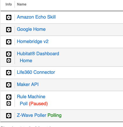

I have no "cloud" things that I know of. Life360 Connector, maybe.

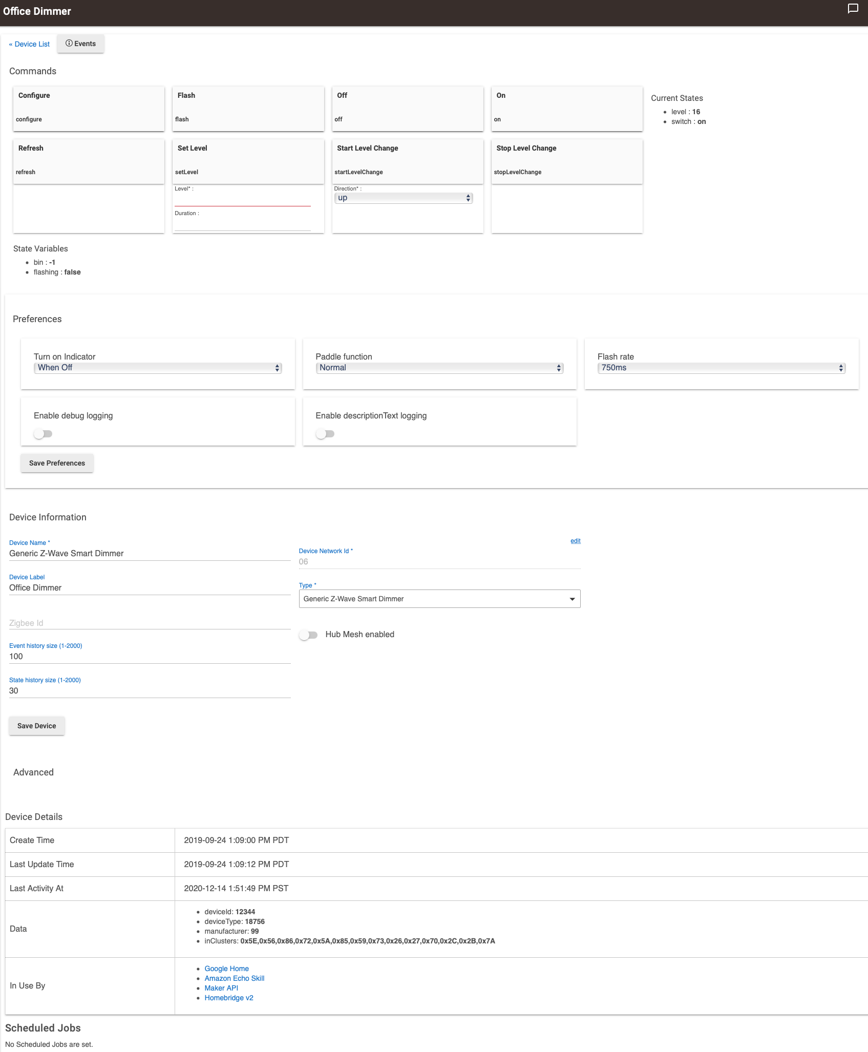

http://hubitat.local/device/edit/11
http://hubitat.local/device/edit/225
These links should take you to whatever devices they are.
Device 225 is something I added a few days ago - Smartthings Zigbee arrival sensor. The problem with memory leak/slowness was long before I added.
Device 11 is a generic Z Wave Dimmer (GE in wall dimmer)
I found them on my own, See previous post :slight_smile:
I think the C-4's have more trouble because they run in a 64bit JVM vs 32bit. More memory consumption unfortunately.
Clicking on those links takes almost 30 seconds to load the page.
Device 11:

Any way to pull the free memory into influxdb or some
Other data source for grafana?
Sure. Lots of ways, actually. As I'm no grafana expert, I would run it through node-red and then to the database, but I run everything through node-red. lol
For instance, here is an example of my memory graph on my node-red dashboard. I just poll the http://hubIP/hub/advanced/freeOSMemoryHistory url, and toss everything except the last entry, then add it to the graph.
I'm still hoping @gopher.ny will add a url to just get the "current" memory stats in the same format, instead of pulling the whole history just to get the current values.
