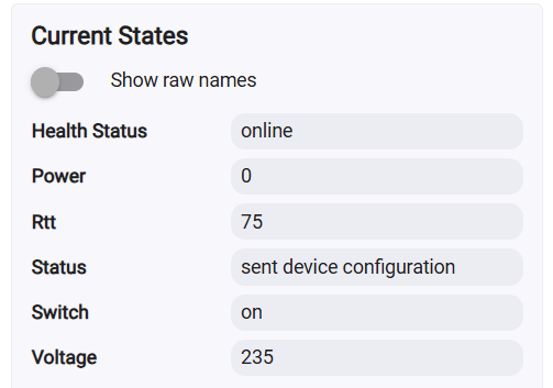

I bought this for the energy monitoring
I was able to configure using the driver
Zemismart zigbee wall switch multi gang
I'm just not sure which driver I should be using for the energy monitoring..
_TZ3000_qlmnxmac
Model
TS011F
I searched for _TZ3000_qlmnxmac and found nothing in this forum
Any assistance / directions would be greatly appreciated
Try switching the device across to the Generic Zigbee Outlet driver and then back to the Zemismart Driver. This seems to have worked for me on these Melery outlets.
