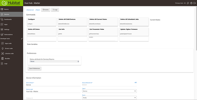

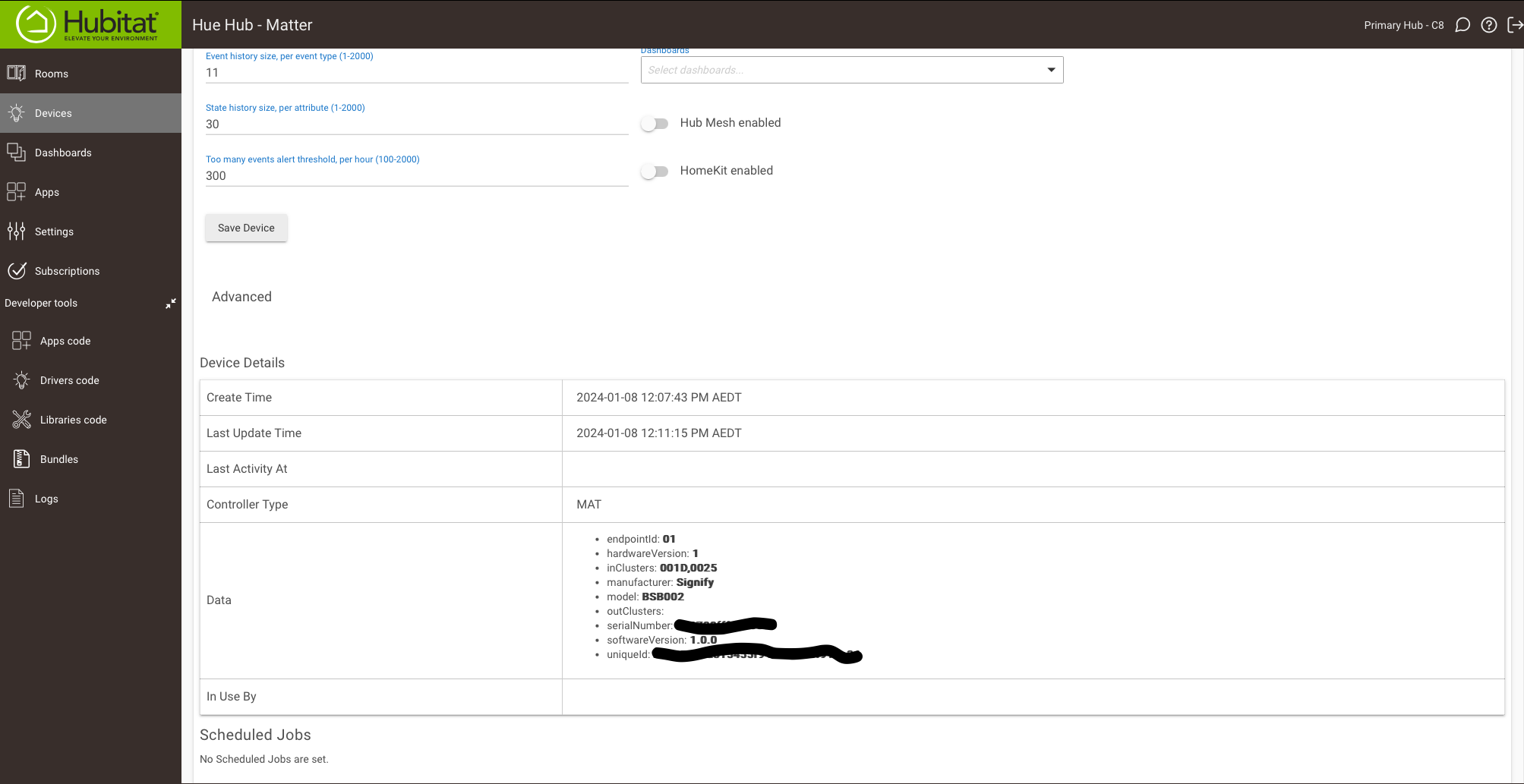

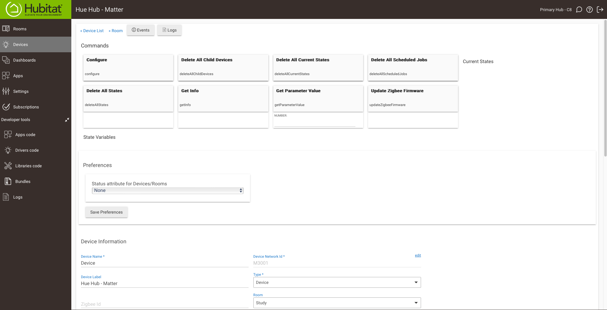

This is definitely a possibility, and it is the route that Philips Hue and Aqara have taken. Their hubs can act as Matter Bridges, thereby allowing some Zigbee devices to be seen as Matter devices to Matter Controllers that support Matter Bridges.
However, this is not the case currently for Apple, Amazon, Google, or Samsung. The 'Big Boys' all will happily adopt Matter devices (either Matter over WiFi or Matter over Thread), some support importing Matter Bridge devices, and most share genuine Matter devices with other Matter Controllers (e.g. Hubitat C8). However, I am not aware that any of them will act as Matter Bridges for non-Matter devices. For example, an Apple HomeKit device that is part of your Apple Home, cannot be shared out to a Matter Controller on your network. A WiFi device that is connected to Alexa cannot be shared out as a Matter device to a Matter Controller on your network. I really doubt that any of these 4 companies will add Matter Bridge functionality for non-Matter devices, as it puts the burden of writing the translation layer code squarely upon them, instead of the device manufacturer.
It makes sense for Philips Hue and Aqara to do this for their hubs, as they want their hardware to be compatible with as many home automation platforms as possible. Adding Matter Bridge support is truly part of their forward looking business model. They want to stay relevant.
This is the current expected behavior on Hubitat, as support for Matter Bridge devices will require child device drivers to be written for all of the Matter Bridge device's children. I think the Hubitat team may have released some developer documentation for Matter. Perhaps a motivated community member will try to build out the Matter Bridge functionality?
Agreed, like I said, I did it to amuse myself.
