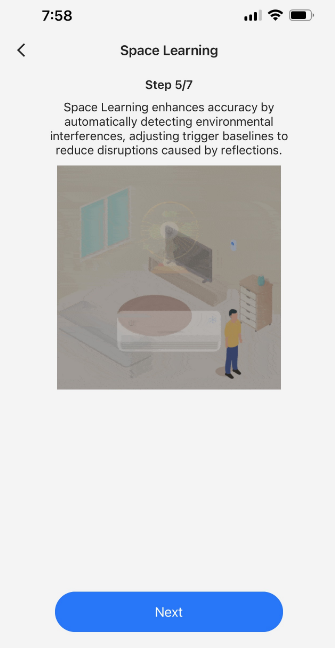

Have you calibrated the sensor using the Meross app 'Space Learning' ?
Does the device stuck on motion/presence detected or 'not detected' ?
Yes, firsts time I was using Meross app ony and performed all installation steps. Sensor worked for about 2 hours and then stopped reporting motion (stuck in not detected state) but still reported light level.
Second time (after factory reset) I used Alexa for commission and then paired with HE using your Advanced Matter Bridge as a driver. Two child devices was created (motion and lux). Calibration was done by double clicking a button. Again everything was OK for couple hours and then motion reporting stopped stuck in inactive but lux reporting was OK.

I removed both sensors from everything and factory reset them. Than added one to only Meross app. At the very beginning everything looked very sort of good. However "Space Learning" always ends up with "Timeout". I am confused what I am seeing under "Detection Range Calibration". Button "Complete Installation" sometime active (but most likely does nothing when pressed) and sometime gray. After few hours LED stopped to turn on Green (occasionally it still blinks briefly). For the past 18 hours sensor is still reporting motion activity which seems to be correct. I am not sure if if functional as it should or not. At least LED behavior is abnormal.
