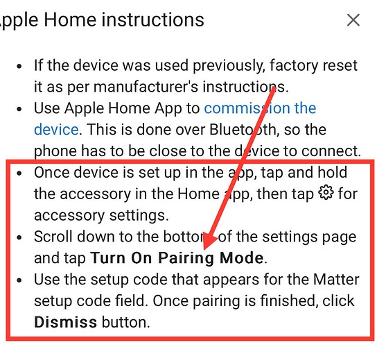

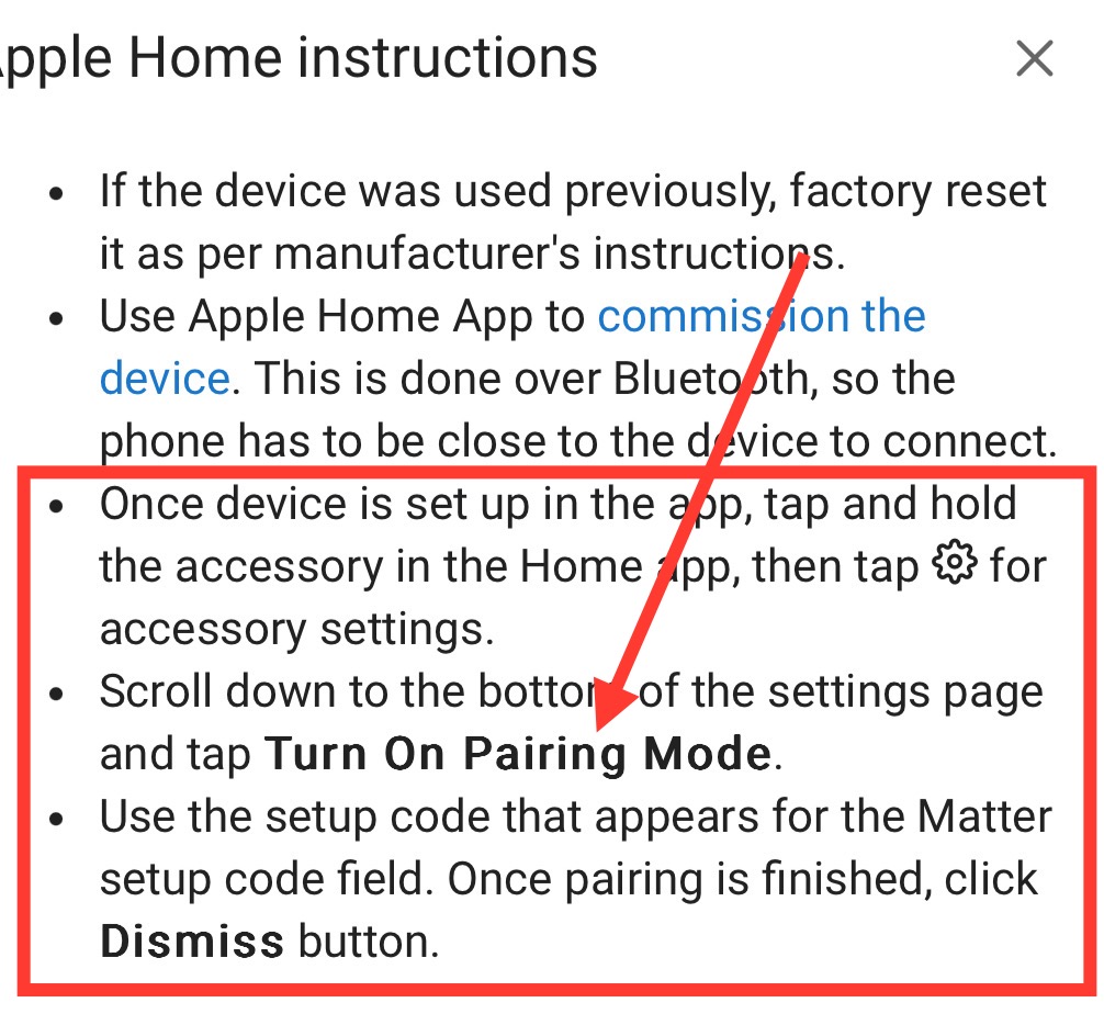

You don’t put the device itself in pairing mode, you put the device in “Matter pairing mode” from within the Apple Home app (or Google Home, Alexa etc.)
From Hubitats instructions…
