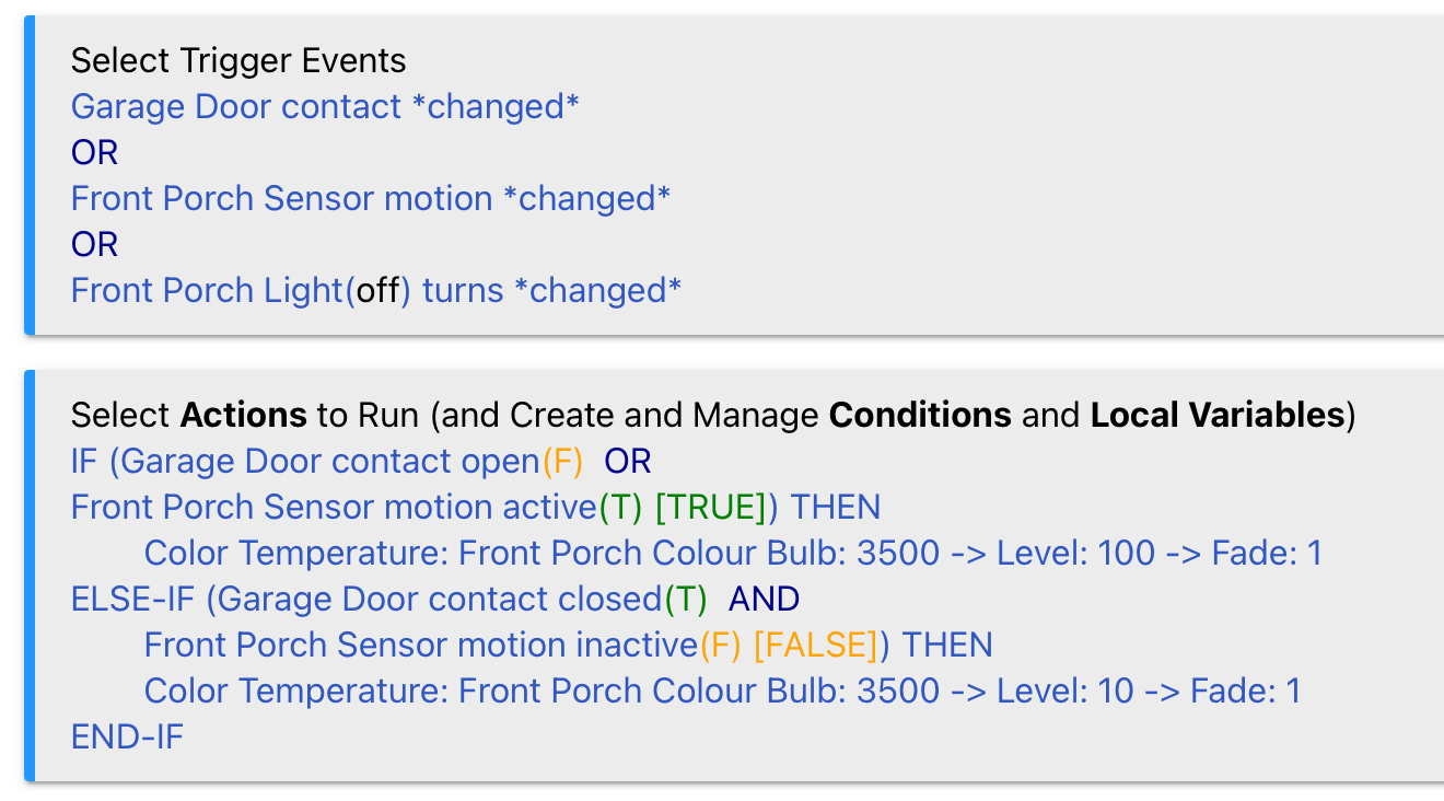

The exception is my outdoor lighting, which now uses Hue Colour globes or down lights. I use RM to turn off power to the outdoor lighting during the day and restore power as the sunlight fades. The Hue lighting rules are enabled by the "switch" turning on, and triggered by various sensors for normal lighting and date based rules for holiday lighting.
It was kind of a happy accident that I ended up with this solution - I used to have a dumb motion sensor for my front of house lighting, and I hated it (very inflexible). So I replaced it with a Hue Outdoor Motion sensor and that gave me a lot more flexibility with holiday lighting etc. This is my normal front porch lighting rule:
