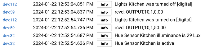

If you think the issue is with the automation, post screenshots of the Rule, and of the logs when the rule runs.
Make sure that logging of events, triggers, and actions is enabled for the rule.

what i thought was working is only half working. the lights are going on when motion is triggering them but they are going on 100% even though the dim is set to 50%
Trigger
Hue Sensor Kitchen motion active
no conditions
actions
Dim: Lights Kitchen: 50
Delay 0:00:10
Dim: Lights Kitchen: 0
dev:1122024-01-22 12:24:55.564 PMinfoLights Kitchen was turned off [digital]
dev:1122024-01-22 12:24:51.640 PMinfoLights Kitchen was turned on [digital]
dev:1122024-01-22 12:24:46.946 PMinfoLights Kitchen was turned off [digital]
dev:1122024-01-22 12:24:18.435 PMinfoLights Kitchen was turned on [digital]
Include the logs of the rule. And the rule itself. Pictures are better than text.
Ok after taking the screen shots i compared what HomeKit was reporting 100% and HE reports it at 50% on the device. Also i double checked the physical switch and it is in fact at 50%.
so it appears that the rule is doing what its supposed to do . The device is doing what i expect it to do but HomeKit is reporting 100%.
if i control the dimmer from HomeKit or HE they both increase and decrease the brightness and both report the same percentage.
the odd thing now is, now that i adjusted the dimmer via HomeKit and HE its still reporting the correct value. but if i let it set for a few minutes it reverts to showing homekit at 100%
could there be some communication issue between homekit and he. they are both on the same wired network.
![Screenshot 2024-01-22 at 12.50.31 PM|690x414]
