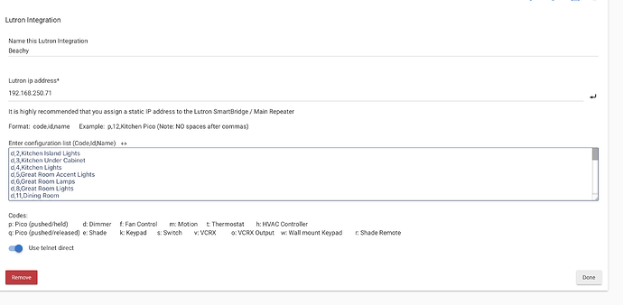

Are you connecting the Lutron bridge directly to HK, or are you using Lutron - HE - HK? What does the configuration on your Lutron app look like. Here is mine.
I also have the Lutron Bridge connected directly to HK, so it doesn't go through HE.
Same here. Using Lutron's native HomeKit integration alongside of Hubitat's Telnet based Lutron integration.

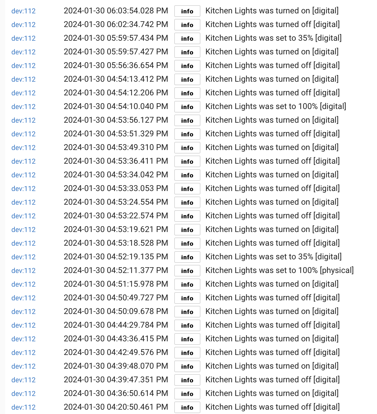

After a few days or even hours the problem comes back. The dimmer value on the HE shows 35%. The dimmer light on the switch shows 35% but no light.
the only thing i can do to get it working again is from HE turn the dimmer to 100% then off then on and it will start working again.
I dont know if it matters but im using Rule Machine for the automation. also the logs dont show anything accept the actions the rule is taking. all of them look normal.
