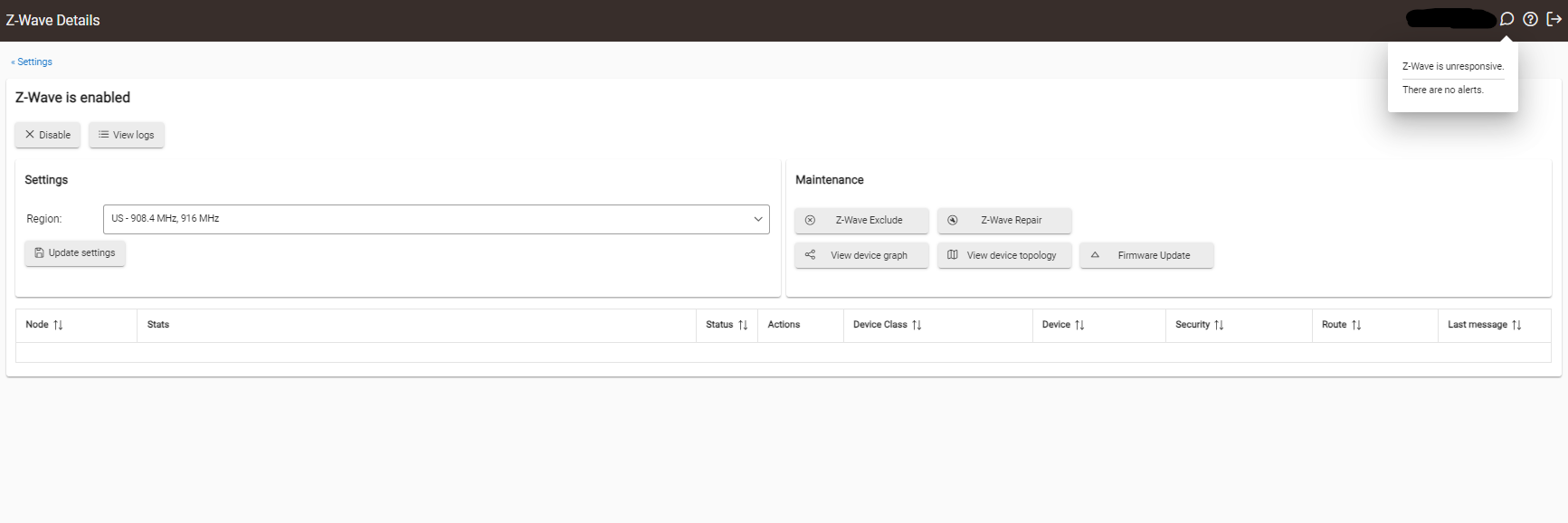

@calinatl Can you post your z-wave details page in its entirety please? Use windows snip
Sounds like it's empty...or did you want to see the page header?
Aside from trying a different power supply/cord, it does sound like Z-Wave may have died an early death.
He posted this so I wanted the details page
Yes, probably clicked the Z-Wave Repair button at the top (for a full repair), on a blank details page. There is nothing to see.

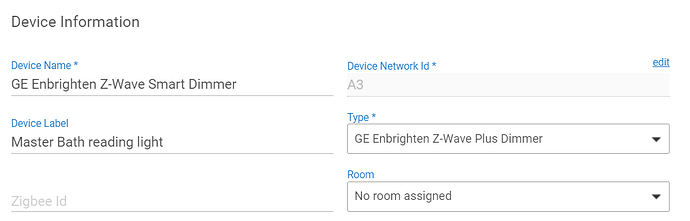

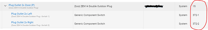

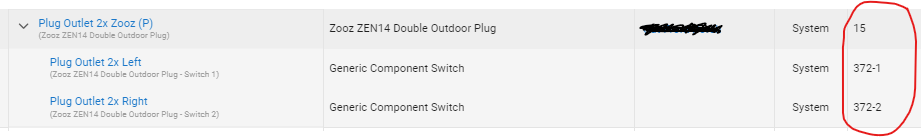

On the device list page, there is a short number for each in the DNI column, like this:
I could enter the DNI number that appears on the list page, appended with "_OLD", onto the Device Info page in the field that states "Zigbee ID", but I'm afraid that somehow HE thinks all my Z-Wave Devices are actually Zigbee, and I don't want to mess something up...

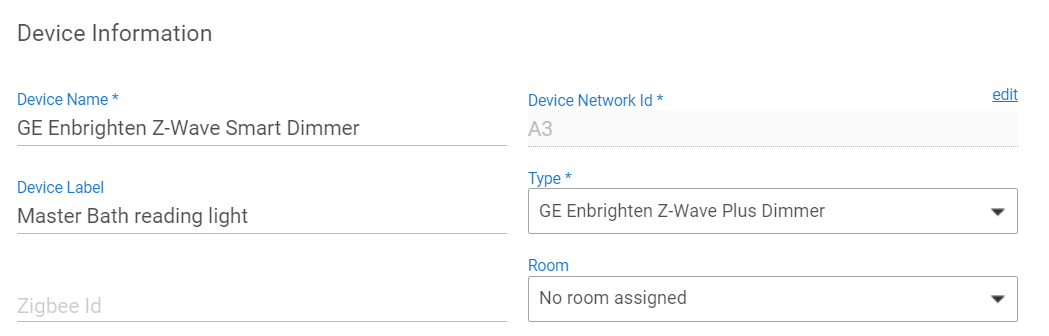

The DNI (Device Network ID) is found on the Device pages...example below - DNI is A3 for this device. That's what you need to edit for each device, per @jtp10181's instructions - append _OLD to each DNI. Ignore the "Zigbee ID" field - it's always there, but not used w/Z-Wave devices.
