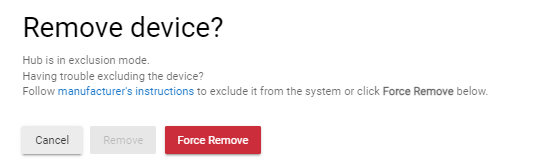

Ok. I did that. I get this:
Select "Force Remove"?

If you are getting the Force Remove option I think you are on the wrong device. That should only show if the DNI is linked to a paired device in the z-wave details list. That is why I said to double check with the DNI having _OLD in it, do not rely on the device names.
When you go to remove a device that is not linked to a paired Zigbee or Z-Wave device it should just remove and go away. The only prompt might be warning you if the device is still in use by any apps.

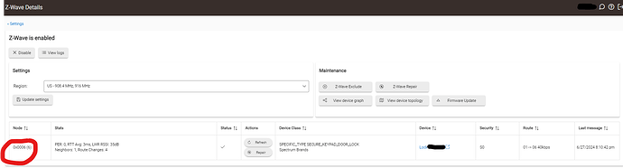

I'm definitely removing the old device, and I don't think the DNI is linked to a paired device in the Z-wave details list (but I'm not totally sure).
This is the Z-wave details list, showing the new pairing of the lock:
This is from the Device details page. The one thing that confuses me is that it says the old one last connected at 4 something today, and it really should be sometime on 6/24, so I'm wondering if I got something messed up when I restored the database to get the Lock codes.

The one with the _OLD DNI should be safe to force remove. There might have been a change in what triggers that prompt recently.

Selecting Force remove removed it, allowed me to properly set the lock in Lock Manager and caused the RM rule (that only involves the lock - it relocks it if left unlocked for more than x minutes) to start working again.

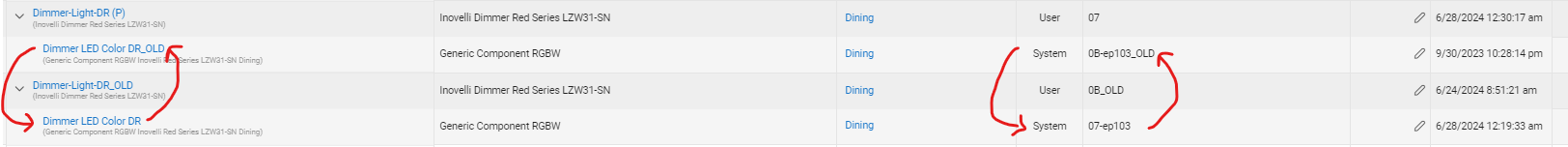

The Inovelli switches worked great for factory reset, but once I re-added them, the old/new parent/child devices are mixed up. I've done the swap for the parent, but there is no option to swap the child devices, and the old child devices are still associated with rules/automations...

Sadly, Swap doesn't work for child devices, not supported. So those you have to change in the automations manually.

@danabw: Since the Parent/Child Old/New are mixed up, I first deleted the Old child device (which was Under the New Parent). Then I deleted the Old Parent. Unfortunately, that also deleted the new child device. So now the Inovelli dimmer has no child device. How do I solve for this?
If the driver is well made, running configure should add the child devices back.
