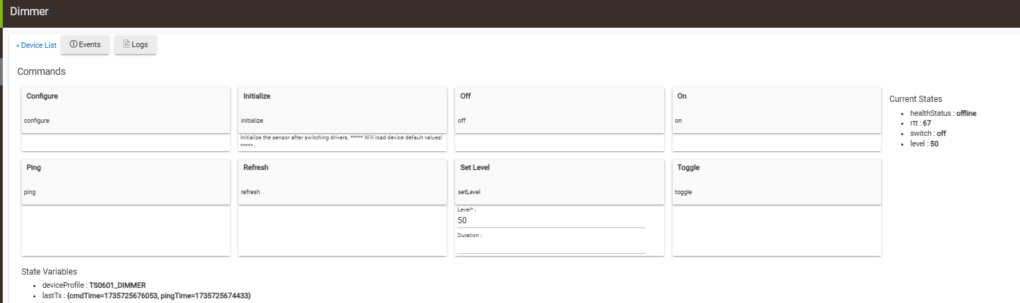

Ive one of these.
ZM-105B-M-MS
This is a new manufacturer device and it will not be recognised automatically.
Use the driver referenced above and set manually the ‘Device Profile’ to Tuya TS0601

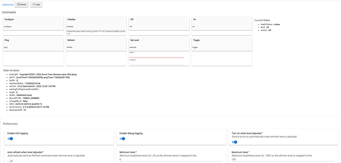

I picked up a moes zm-105b-m dimmer.
I managed to get it up and running with this driver, and swapped to tuya0601 profile.
I was attempting to get this working with a rocker switch.
I currently have an old zwave fibaro dimmer attached to the exact same style switch. On the fibaro, If I
  • press 'up', the light comes on.
  • hold up, the brightness increases.
  • press 'down', the light comes on.
  • hold down, the brightness decreases.
Perfect really.
Can't seem to get this to function the same.
The best I can manage is to have the the up/down sides of the rocker switch apparently control two completely separate loads. Behaviour on this is, if I
  • press 'up', the light on load1 comes on.
  • press up again, the light on load1 goes off.
  • hold up, the brightness (load1) increases.
  • hold up again, the brightness (load1) decreases.
  • press 'down', the light connected to load2 goes off, and
  • the switch reflects as off. Leaving load 1 in it;s previous state.
    etc.
Oddly, the brightness level for 1/2 seems to be remembered, but whichever switch was pressed most recently is the only one which is displayed.
If I press the other switch, the brightess and status of that switch replaces the info above. Press the other switch and ditto.
It's as though the driver can only display one load status/brightness at a time.
I'm assuming I've just hit unlucky with this item, and the up/down rocker switch functions (as per the fibaro) simply cannot be duplicated.
All Tuya dimmers I know are working this way - short press switches on/off, long press started dimming up or down. I am afraid you can not find a Tuya dimmer that will work the same way as the Fibaro dimmer, and the reason is that rocker switches are not popular in CN ...

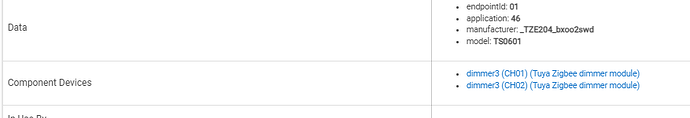

Please post the device Zigbee details (model & manufacturer).
Did the driver create two child devices? If not, then the behavior will be the strange one that you describe - the two channels will interfere and will update the same attributes.

And there are no child devices. Just the single.

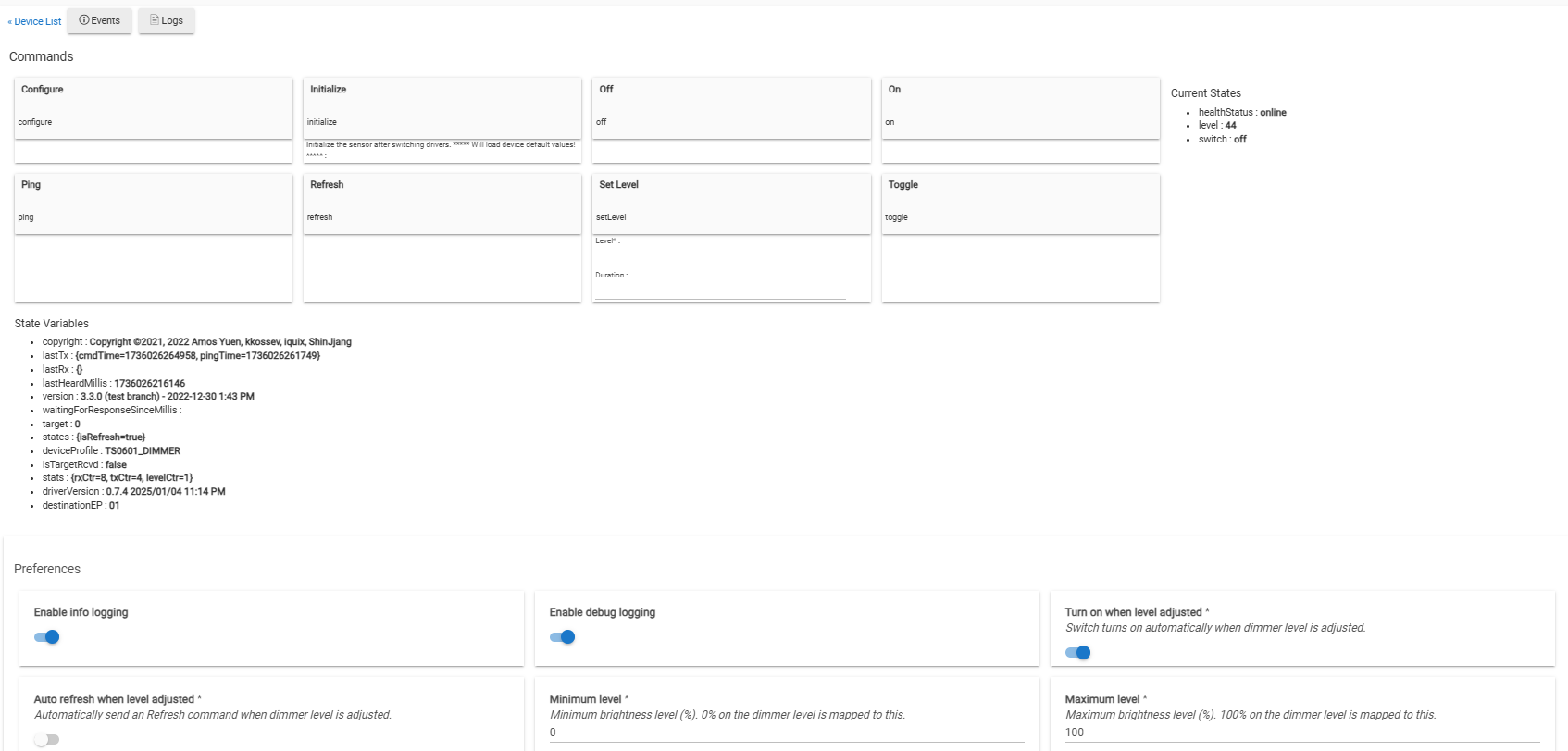

Please update the driver manually to version '0.7.4' :
https://raw.githubusercontent.com/kkossev/hubitat-matt-hammond-fork/development/drivers/tuya-zigbee-dimmer-module.groovy
Then click on the 'Initialize' button and refresh the device web page - a second child device should be created now.
Use the child devices to control the two channels.
No joy.
What am I missing?
ah, thick mode.
Excellent! ThanQ!!
