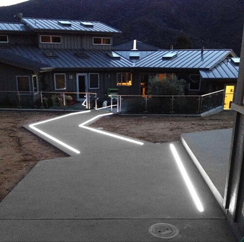

Oh snap, that looks awesome

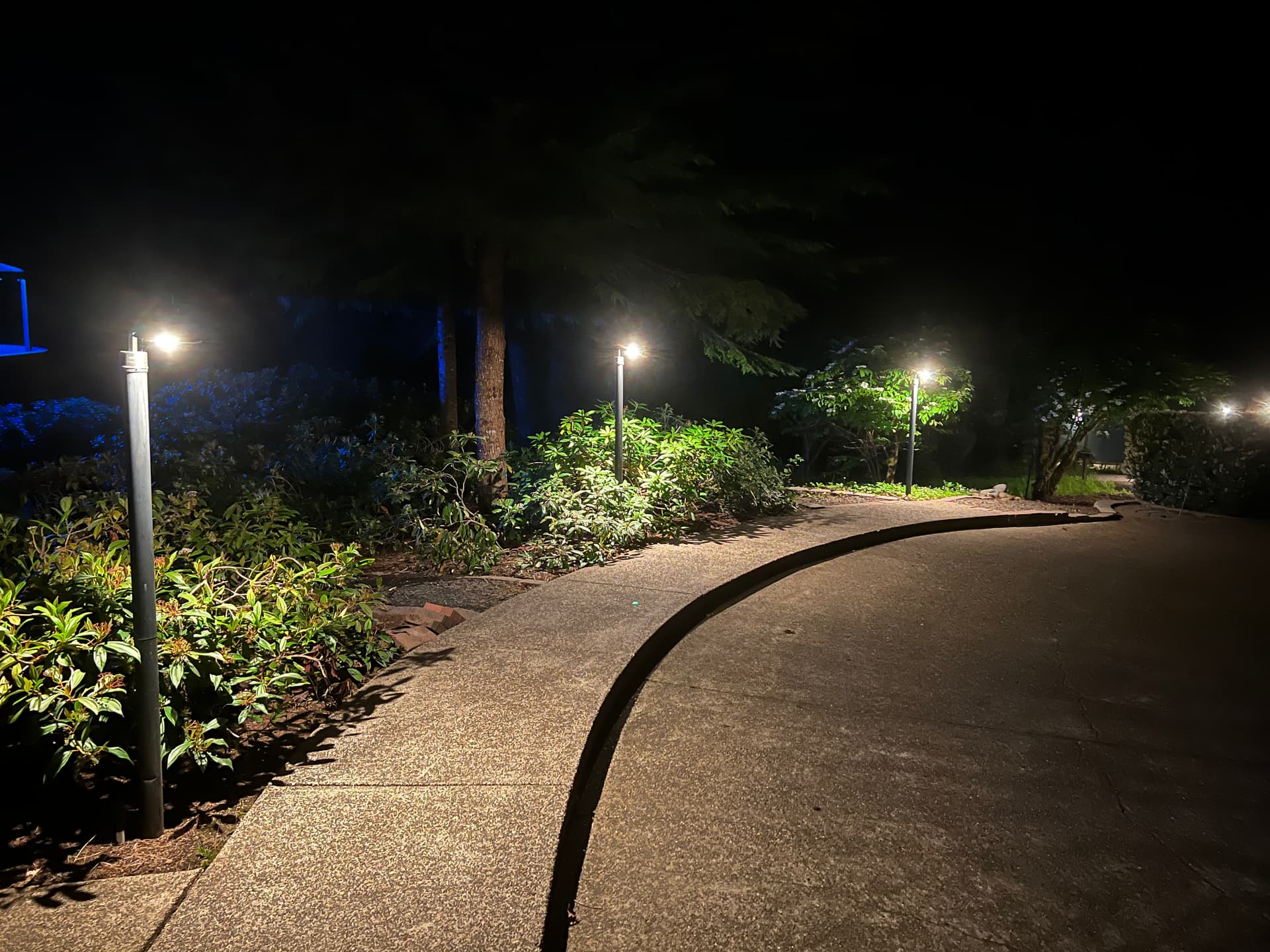

My solution was direct burial 120 volt wiring going to lamp posts. This gets the light showing the ground rather than your eyes.
