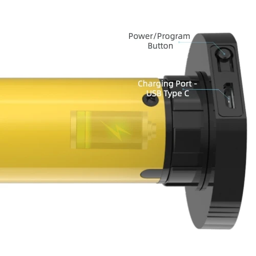

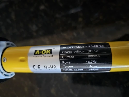

I got a new A-OK AM25-1/25-ES-EZ (DC5v rechargeable)
A-OK-AM25
However this is a newer model and does not have a micro USB socket but a USB-c socket.
usv-c
It is no longer found as model: TS0601 but as the following:
