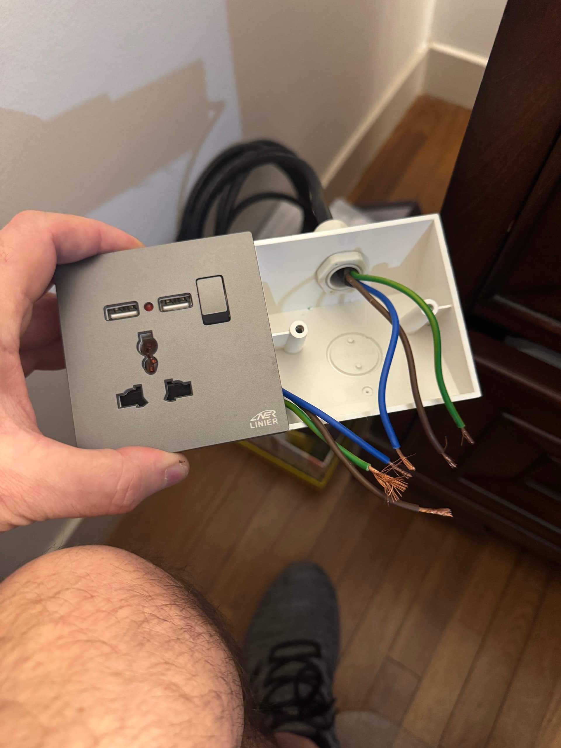

I also bought a few of there Zen 52 relays. they can operate on 120/60 or 240 50 hz. It might be a DIY but im in the process of building a couple of "extension cords" and used a double gang box so i can insert the zen 52 in to the plastic enclosure and strategically place them around the condo to help strengthen the mesh. When my Zen 52s show up next week. Wish there was easier options but not many options for mains powered z wave at 240v 50 hz.

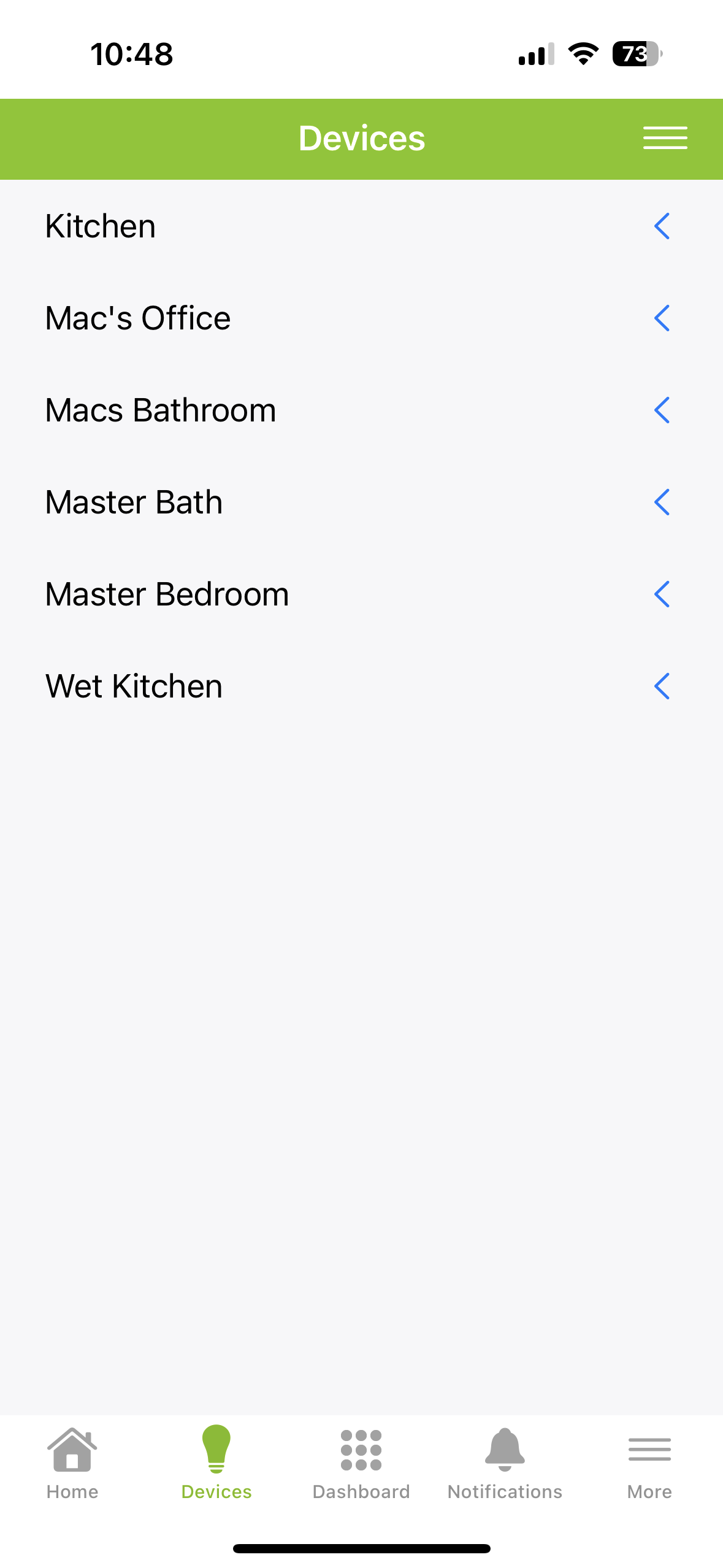

I’ll have to look for it on the web interface. For some reason I don’t get an add devices option on my Mobil app.
I have 2 hubs. One in my house and one here in KL.
I made sure I was logged into the correct hub
Then navigated to the devices tab. However. I don’t see a plus button to add the device.

Either you aren't local or the mobile app thinks you aren't (you'll see "(cloud)" on the Home tab). If you are local -- you need to be -- and it doesn't think you are, this is a bug in the current production release, which is resolved in the public mobile app beta if you wanted to try that; otherwise, the old version that it sounds like you still have can also do it.

Oddly enough, while i cant see a + option on devices in the new app to add a device, i can see add smart device on the old app using tools (wrench icon) . I tried adding it using the camera, It recognizes the QR code and prompts me to add a device name but after that it simply goes back to the smart start screen and says no devices added. tried to add multiple times

Odd that i don't get an option of adding a device form the latest mobil app.

Appreciate the help. I installed the beta app. it shows version 2.11 (390)
However - still showing set to cloud and still no option to add devices ( + Button) on the devices page.
Will either try and figure out how to get off the cloud and get local - or wait for the app to be updated.

Maybe uninstall and reinstall? The issue before (if you had a new install from after this bug was introduced) is that it didn't request Local Network access, which you can also check in iOS settings though might not be there if the app didn't ask in the first place.
No Joy sadly.
Couple of things I did check an update.
I noticed in the web interface under "WiFi settings" that there was no network set up. So I selected my wireless, typed in the WiFi password and now my network is listed
Rebooted the hub
confirmed i was still showing my network in wifi settings
ensured my cellular data was turned off and i was connected to the same network ( its th only one i have) and to be certain it was connected to 2.4 ghz
uninstalled and reinstalled the beta version app
Checked the iOS settings. Enabled local network access
logged in to the Mobil app
Still showing cloud.
-Still no + option under devices
Only thing i can note is on the app, when i select where it says cloud...that under Home wifi network...it says "Null"
I simply cant force it to the local network.

This does not matter unless you want to connect the hub using Wi-Fi. Since you were able to access it before, presumably you were using Ethernet, which should work.
As for the rest, not sure, but it seems like you've tried some good troubleshooting. It's possible there will be more fixes in future builds, though I'm not aware of any recently. That being said, traditional inclusion should still work, if nothing else!
