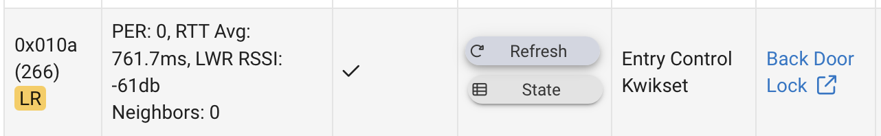

The new Kwikset 620 is Z-Wave LR (LONG RANGE) and I have 3 that work flawlessly.

One of my LR locks is over 50’ from hub a separated by 4 interior walls.
