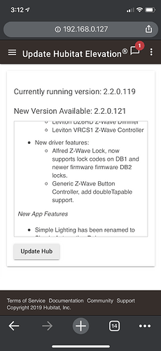

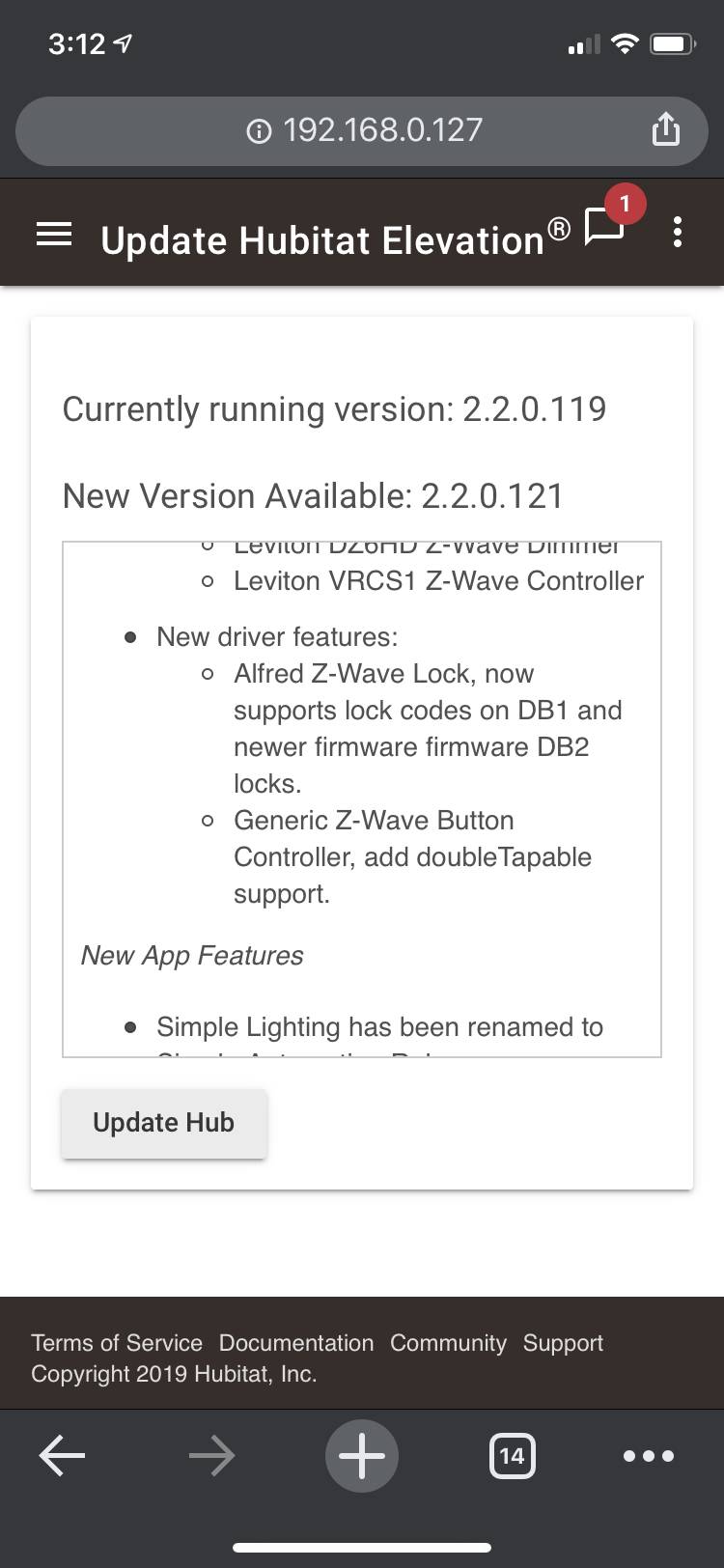

As @aaiyar wrote. You need to make sure your lock has the newer firmware as well.
I am not able to confirm anything right now as my environment is in a bad way. I'm not touching anything as I'm waiting on some devices in an effort to correct this. Otherwise I may just walk away from the entire shebang for a while.
I'm not sure if the firmware update was for the DB1 (original version) or the DB2 which is newer so should have newer firmware. I've sent an email to Alfred to find out.
