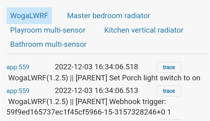

Do you see a log for the state change when using the lightwave app, for example I see:
Ok so I get this type of message in the log when the status is changed by Hubitat
WogaLWRF(1.2.5) || [PARENT] Set Worktop four switch to off
When I turn on that same Worktop four switch using the lightwave app I would expect the status shown on Hubitat change to on but it doesnāt change at all and nothing seems to appear in the log.
Does that help?
Try turning debug on, activating webhooks again, then trying again.
If you look at my log I received a webhook first, then the state changed.
