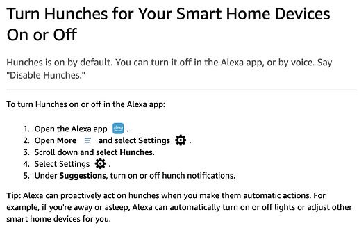

Yes, turn off Alexa Hunches in the Alexa app.
You’re saying to turn off “hunches suggestions?” It says Alexa will notify me when it has a hunch but I never received any notifications so not sure if this is the cause. I turned it off either way. I hope you’re right.
That is correct but her notification or really suggestion of a hunch will often come right after you ask her to turn on/off a light and you might not realize what she is asking and the downfall of saying "yes" to her question/suggestion.
If turning off hunches solves this, you aren't alone in Alexa causing havoc with hunches. Search this community or SmartThings community and you will see many many posts from the past several years. When questions like this get posted the first question is usually do you have Amazon Echos in your house :slight_smile:

It’s hunches or a routine.
Hunches show up in a separate activity section in Alexa history.
I would use the voice command “disable hunches” to make sure it is off.
