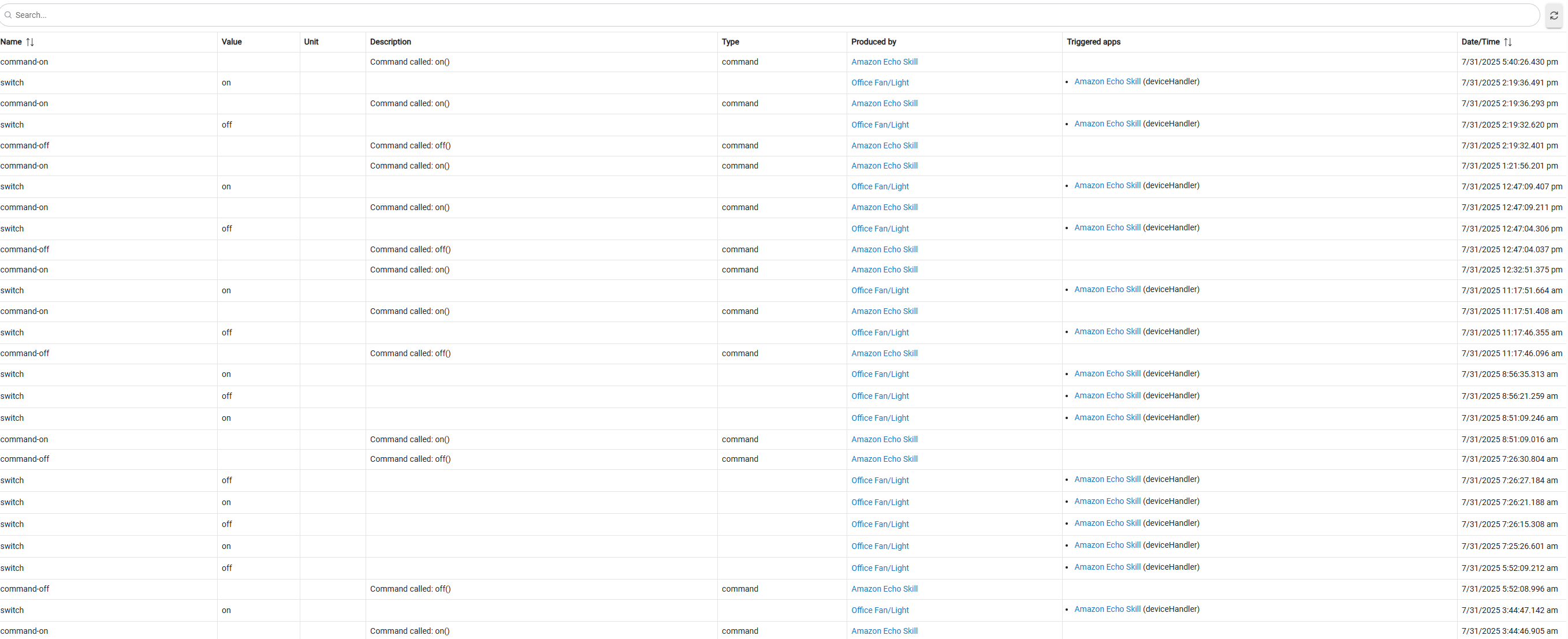

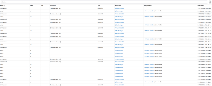

That is what is so strange. It says Amazon Echo Skill BUT I have hunches off and away off. Here is an entire day. Most were me but somewere auto. Whenever you see it go off then I turn it back on a few seconds later. I RARELY turn it off during the day. When I do turn it back on I do use the Echo to do it as the switch is across the room. I cannot find a single Activity entry in Alexa app where it flips the lights but Hubitat blames it so it seems to be true.
You can even see where its already on and then Amazon tries to turn it on again, waits a little bit and then turns it off.
