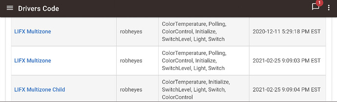

There appears to be 4 per minute, Lifxmaster kept up to date by HPM. I did just notice I have 2 multizone drivers and a mz child. Should I delete one?
That's weird, I'm guessing that HPM didn't match the older multizone driver correctly for some reason. I'm not sure what will happen if you delete the older driver, you may have to rediscover.
Ok, I'll give it a try. Thank you!

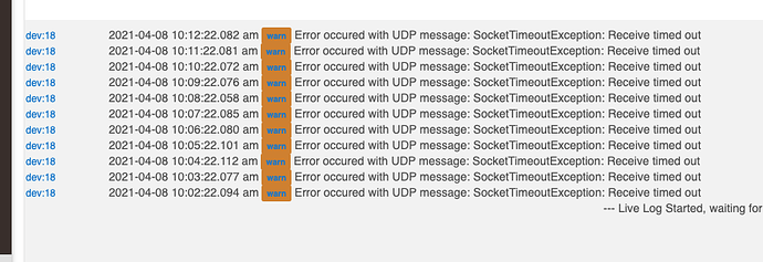

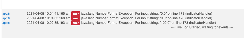

@robGot some odd errors today:
Can you make sure you're using the latest version? The easiest way is to use Hubitat Package Manager.
I thought I'd got rid of all those actual errors a couple of months back, have you maybe recently added some LIFX devices to a group?
For the UDP errors, there are a number of possibilities:
  • The IP address of that device has changed
  • The device is switched off at the mains supply
  • Something is causing a problem with the communication from the device to your router - if you can control that device properly that seems the most likely to be the issue.
Some info:
  • I'm on the latest version
  • All my LIFX bulbs (32) have static IP addresses
I power cycled the lights and that sorted it out for almost 5 hours.. then it started again... not sure what is going on
Okay, what types of devices are you using? It's possible I missed a change in one of the drivers.
30 of them are LIFX Color, and 2 of them are LIFX original (which I think are colour as well)
I've updated the code to ensure that it is using integers for all these values (I hope!). Try the latest version (1.0.3). If you're using HPM then it should find it automatically, otherwise just update the LIFX Master app code.
Oops, I screwed up device discovery in this version - fixed in 1.0.4

I'm still seeing the dreaded "Error occured with UDP message: SocketTimeoutException: Receive timed out" warning. What line(s) in the code do I comment out to get rid of these warnings?
