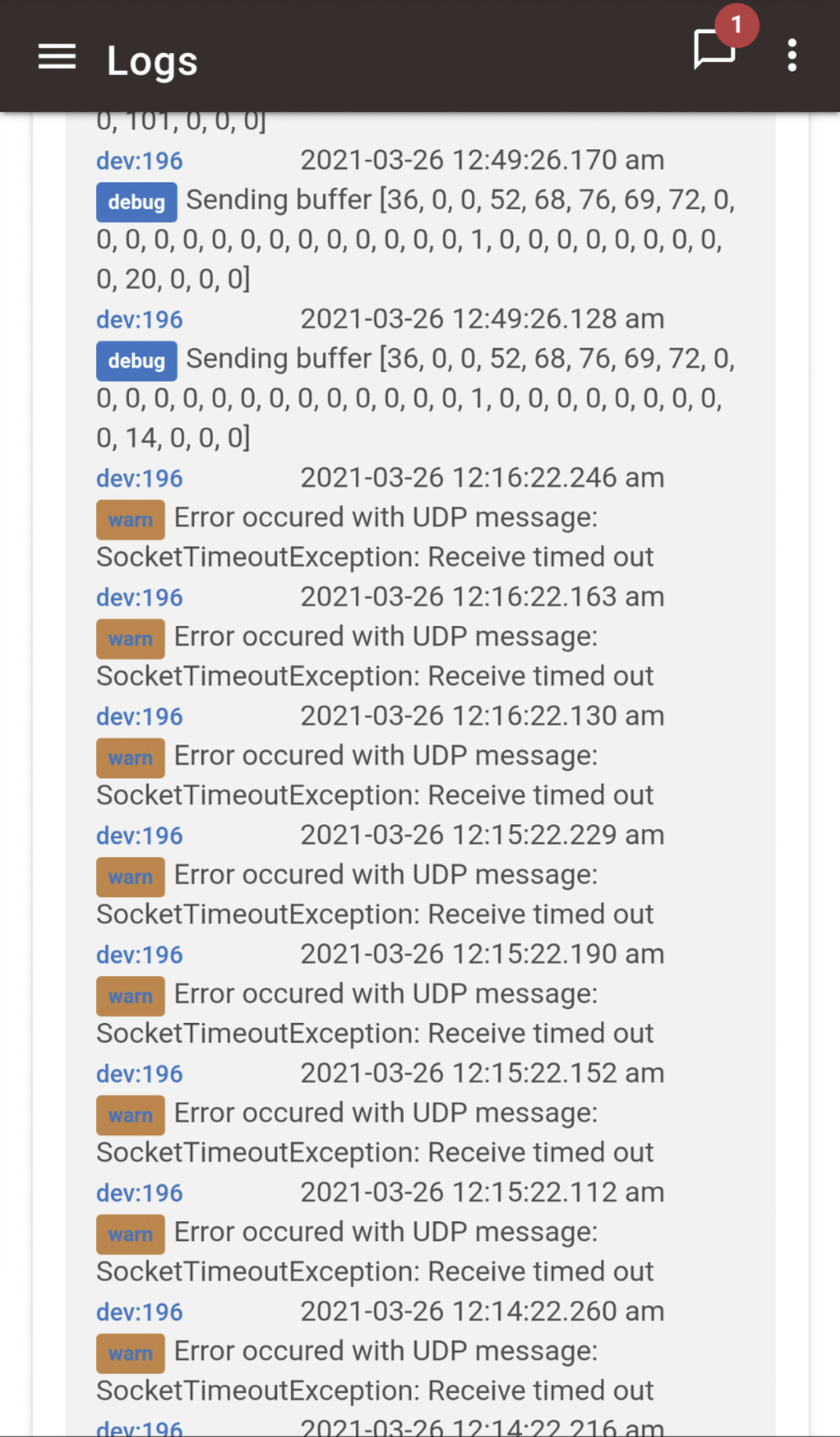

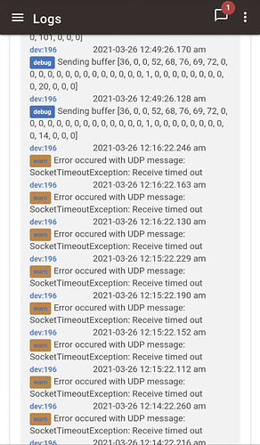

Hi Rob, I also get the socket timeout exception warning but the Z strip works when I trigger it in hubitat. The log shows it a few times per second.
That's concerning, you really shouldn't see that more than once a minute (actually 4 times in each minute since there are 4 queries during polling), something's gone wrong with the scheduling, are you using the latest versions of LIFXMultiZone and LIFXMultizoneChild?
