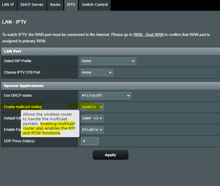

@aaiyar @rlithgow1 thanks for your advices and clues. Everything I was reading after your comments pointed to the multicast mode... again. So I couldnt believe what @aaiyar suggested me to do didnt have any impact.... After more reading, just did another test this morning after making sure that IGMP was on (even if I did the test yesterday):
Rebooted HE and I now have Lifx discovered immediatly. I really dont know what happened yesterday. Either a Snafu or a Code 18...
In anycase I'll monitor it again but it looks this setting change had an effect
Thanks for everyone support in leading me in the right direction.
multicast is definitely needed for lan integrations like that (this includes homekit) So glad you got it running!!!!!!
