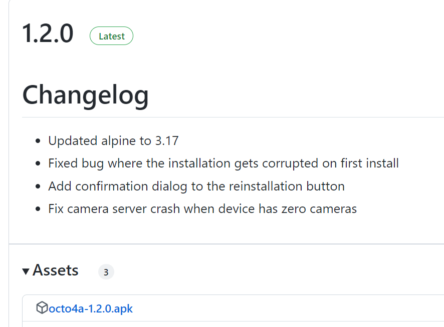

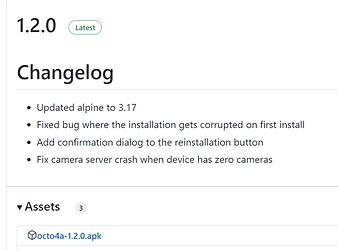

Octo4a finally installed for me OK on one of my Android devices when I downloaded and then side-loaded the current build from the Octo4a github...
So maybe try side-loading the 1.2.0 Octo4a apk from there.

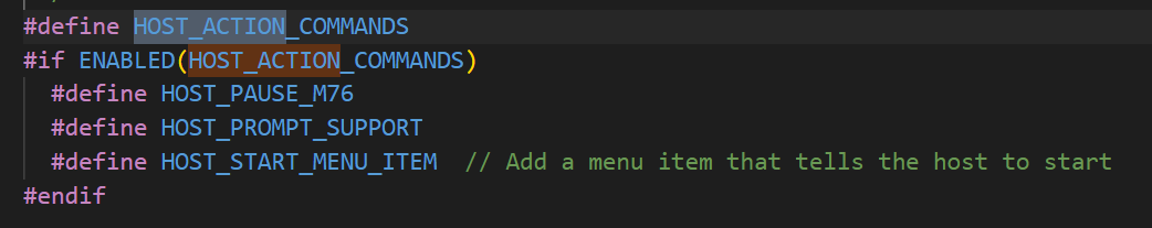

Also, depending on your printer FW (can't remember what printer you have) you may need to flash a new FW build that enables Host Action Commands - they are required for Octoprint. Some printers have it enabled out of the box, others not. In Marlin just a few lines need to be uncommented so they look like below, so a simple change but does require a FW recompile/flash:

Yeah, I get the corruption problem everyone mentions in the issues and discussion and I can't do the manual fix because SSH doesn't run. I think my phone is too old. I can't even update stuff from the Play Store. Android 4.4.

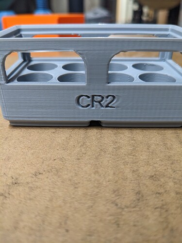

Every time I have a bridge on my print, I'm just surprised it's even possible at all. Had to sit and watch it on this print.

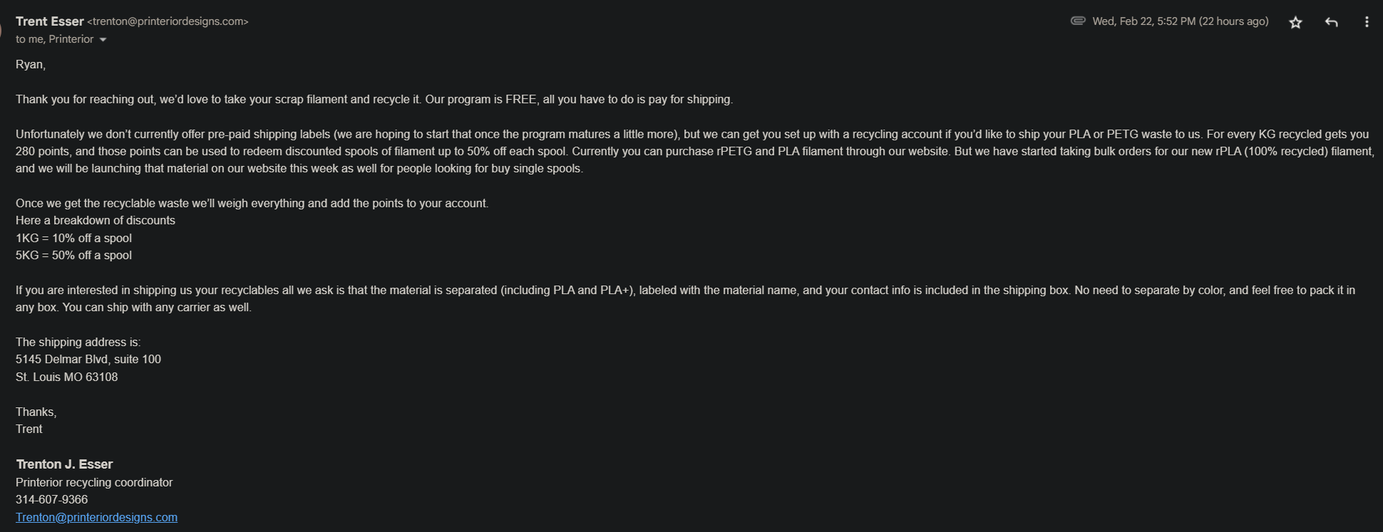

I think I'm going to go with Printerior. Funny enough...I just contacted them yesterday. You have to pay for the ride along with sorting by type...even PLA from PLA+...and then they give you points to use for purchasing their filament.
Think I'll just pick up a few USPS flat rate boxes, fill them up, and send them in as I go.
