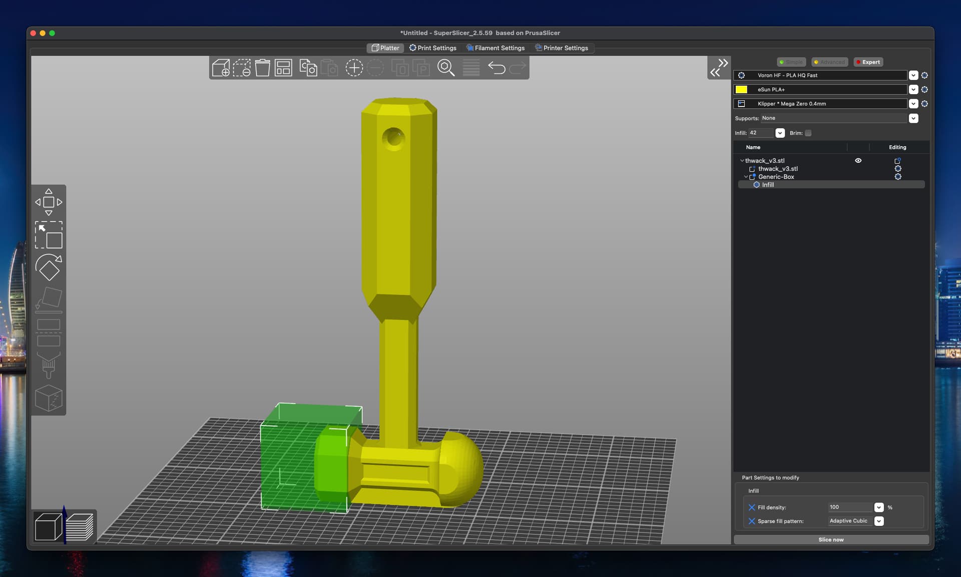

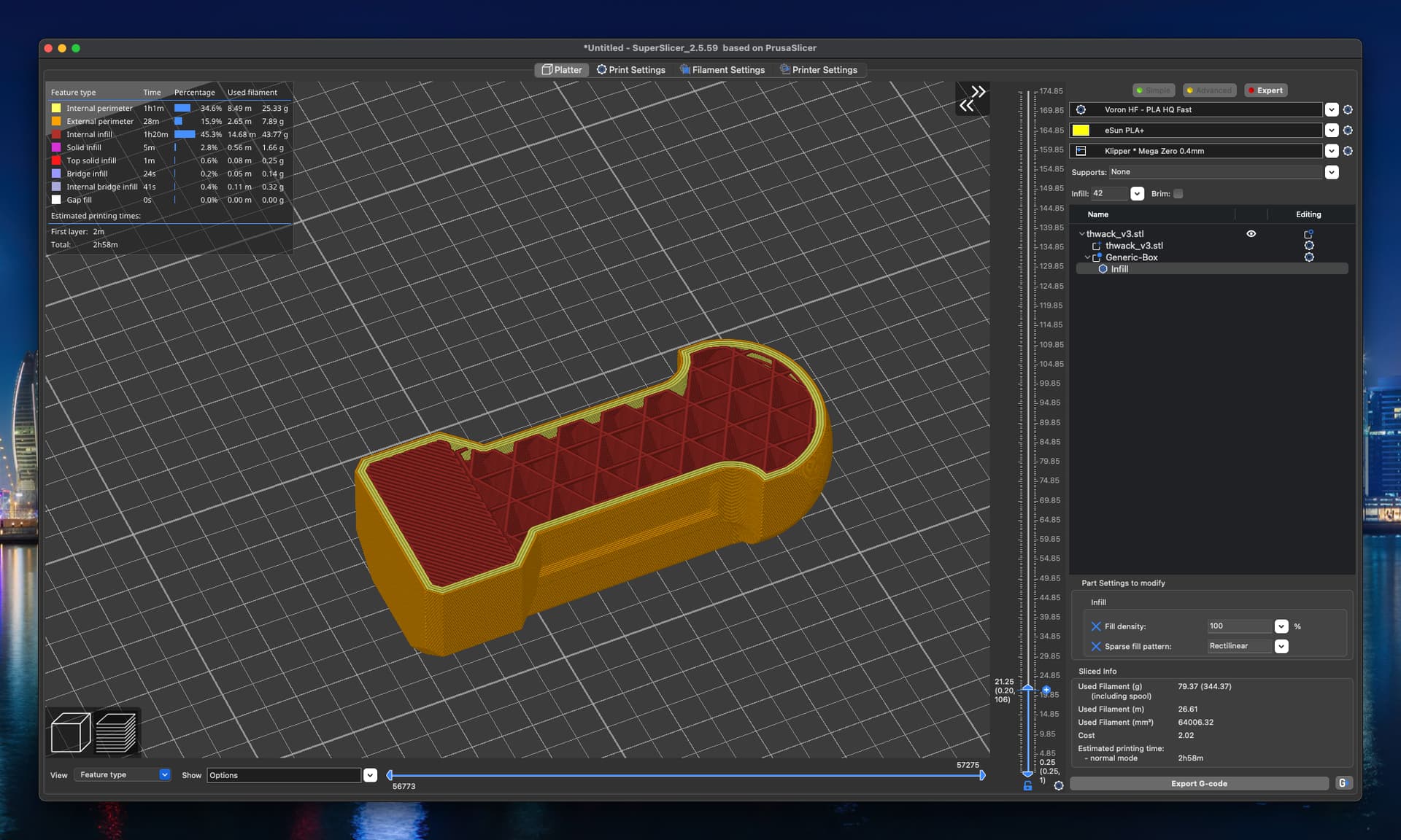

That reminds me, there are some neat tricks you can do with PS/SS (not Cura AFAIK). Say you want a part to have only 1 section that is 100% in-fill. You just add a modifier to it and set the infill to whatever you need. eg The face of a Hammer:
https://www.printables.com/model/46099-thwack

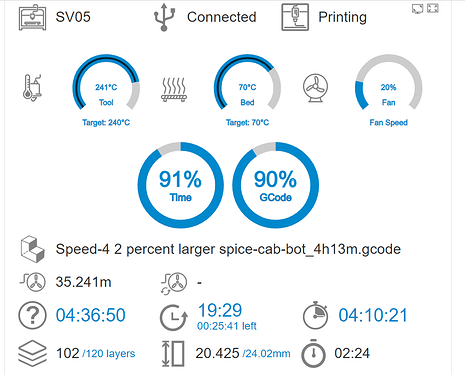

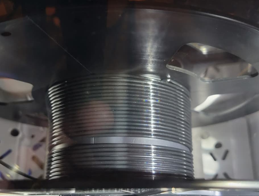

Finished up one of the prints for the 7 sets of spice racks I'm making for my wife (forced labor - heeelp me! :wink: ) and was pretty happy how close I pushed/timed it to the end of the current spool. Finished the most recent print just after I got down to the very last wrap of filament on the spool!
Nice! I rarely get that close to the end of the spool. I have "running out anxiety" I think, so end up with a lot of 15-20% left spools. :confused:
Yes, me too, actually. You'll notice I only posted the pic of one of my remnant spools. :wink: The other two I have both have more. I'm trying to use an Octoprint plugin that keeps track of filament used on each print. I had already printed stuff before I started using the plugin, so there was a fair amount of guessing and I got lucky this time. :smiley:

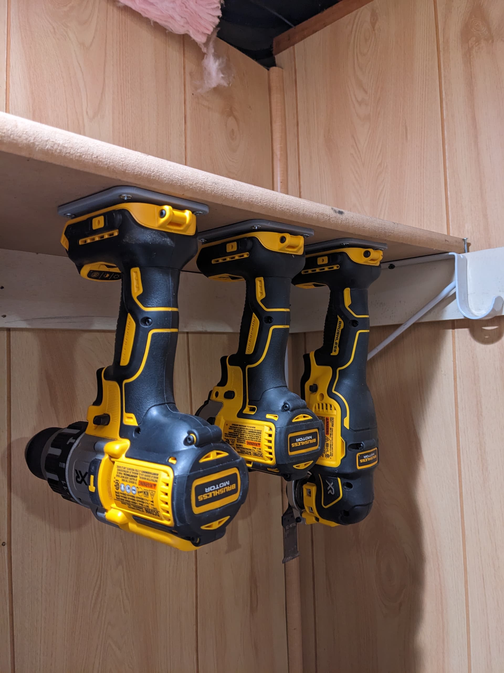

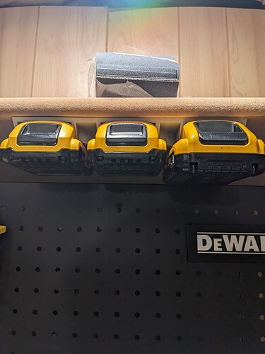

I'm not sure it's as exciting as those spice racks, but printed some adaptors to hang some of my tools + batteries over the weekend. They used to just sit on top of a work bench, so this should be a little more organized.
Oh baby, 3D printer and tool porn combined. That actually looks very cool!
That was my dream. I have them bookmarked. But then the girls saw drawer organizers and cosmetic trays.

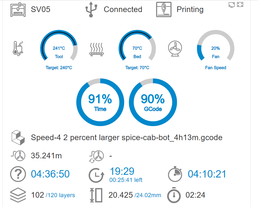

The Dashboard plugin for Octoprint is so good...
