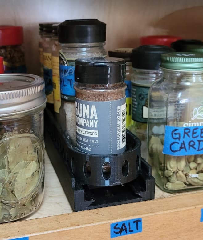

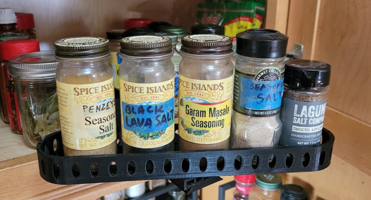

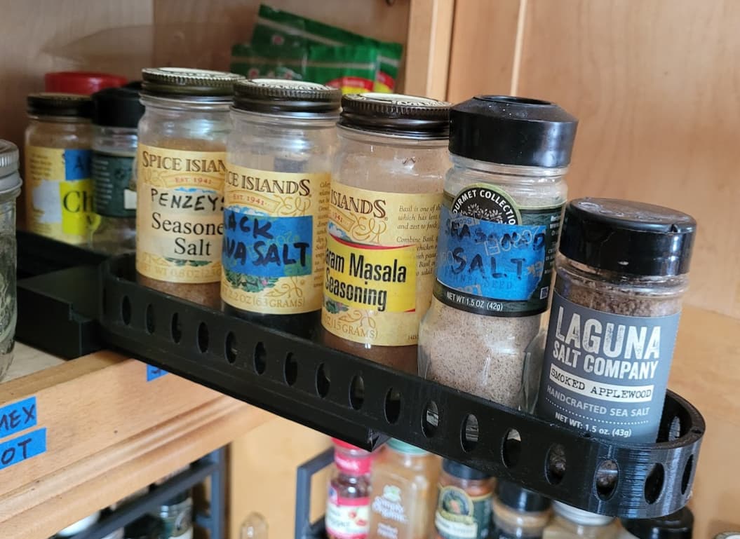

3D printer WAF win today. :slight_smile: Sliding spice rack from Thingaverse. I only used the bottom part of the design, as our spces are in a short space in the cabinet and the metal rods and top in the original design would just get in the way for us.
Big win...wife wants more. :slight_smile: I reduced the width of the bottom rail to 98% and it slides easily. The sliding bottom rail at full size needed too much sanding to slide well. Only issue at this point is it's a little tight on the larger Simply Organic square spice bottles. I may try printing everything but the sliding bottom rail 1 or 2 percent wider so I get more space and the rail will slide easily.
Sitting quietly...stealthy coolness:
Slide out:
Rotate in mid-air... :exploding_head: Mind blown: :slight_smile:

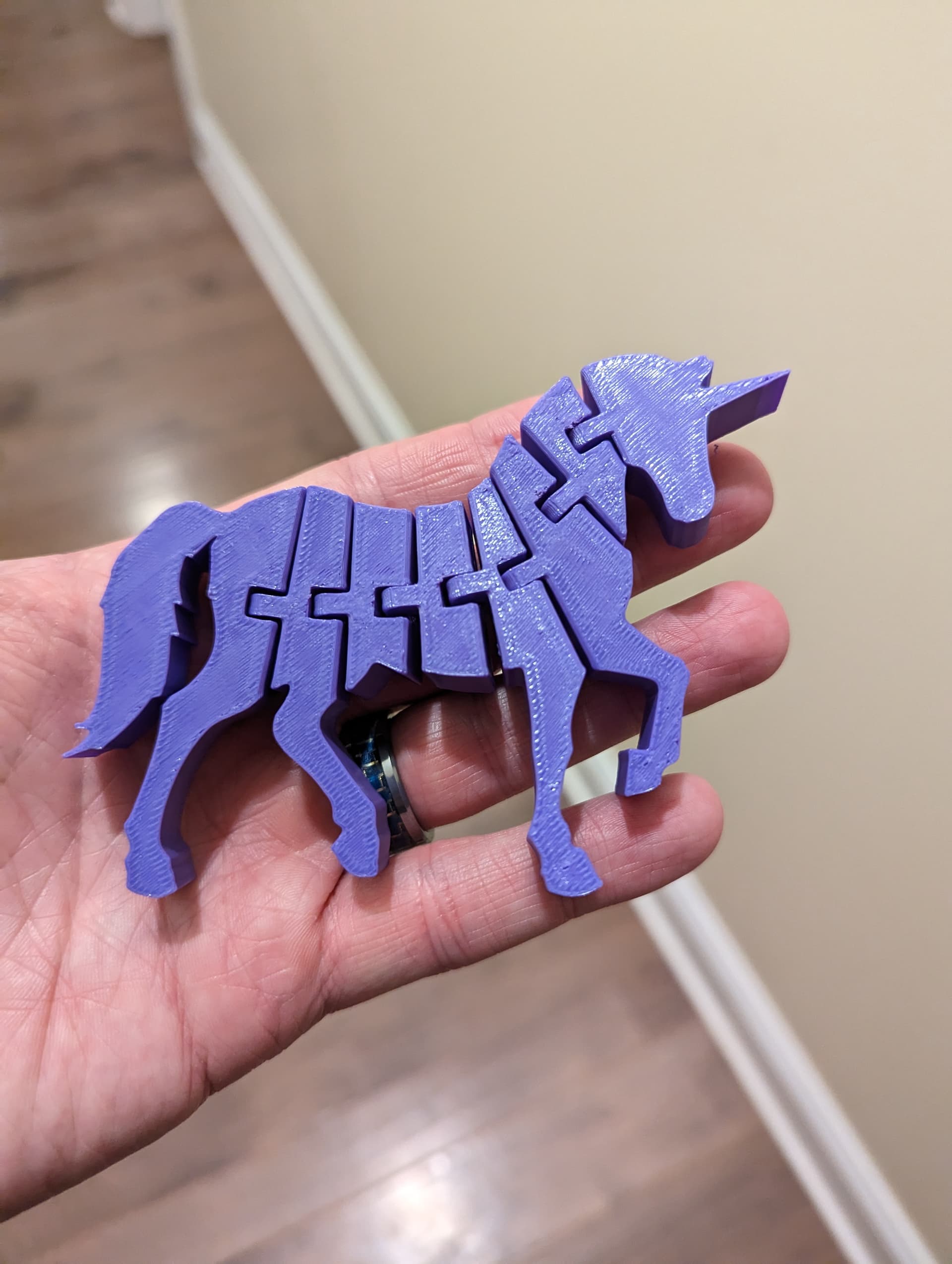

I did print my first articulating model for the GFs 7 year old. Came out pretty nice!

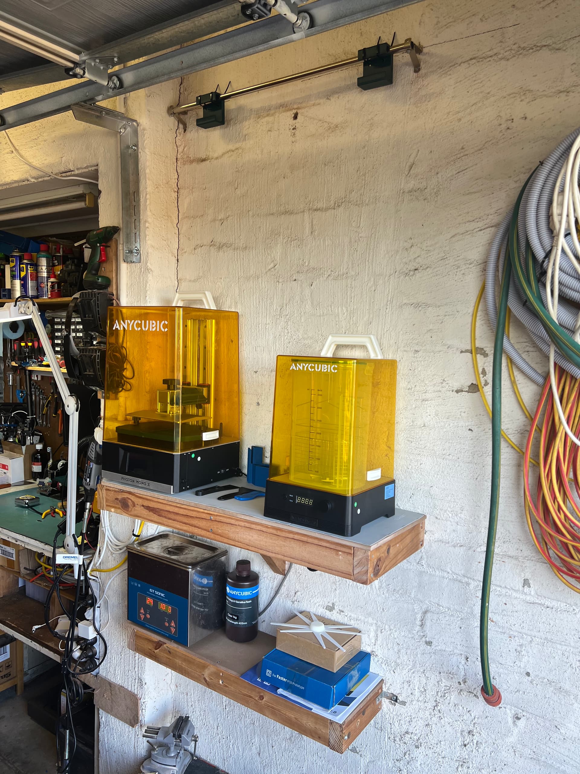

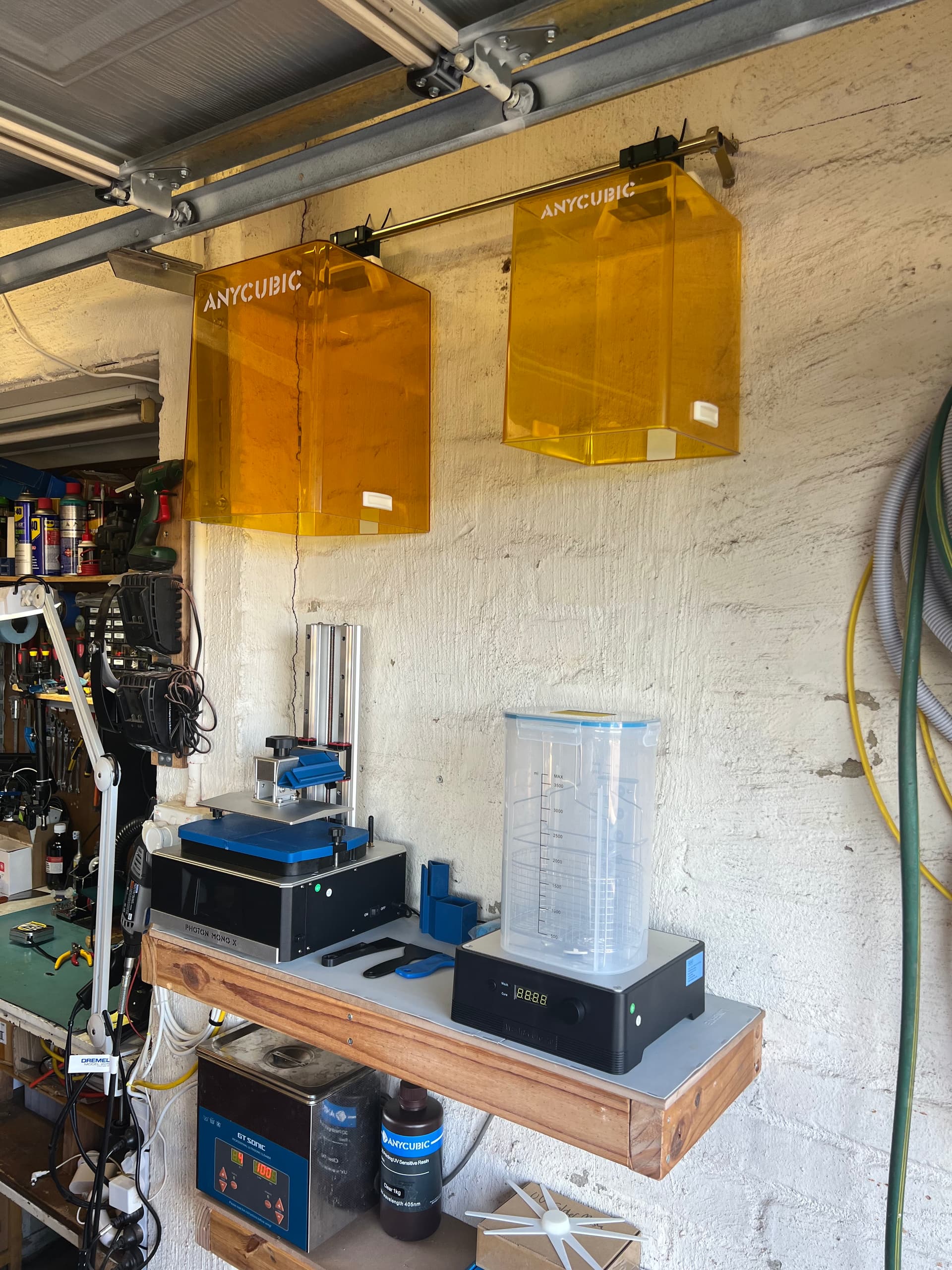

I made a simple hook in Fusion 360 last night and printed out a couple, now I can hang the lids out of the way. The curtain rail was already there from a previous use case.
Wow...that looks so legit. Five stars for both usability and slick/sleek design.
Cheers, it’s really nothing fancy.
https://www.printables.com/model/403948-simple-hook-hanger-for-anycubic-photon-lids-using-

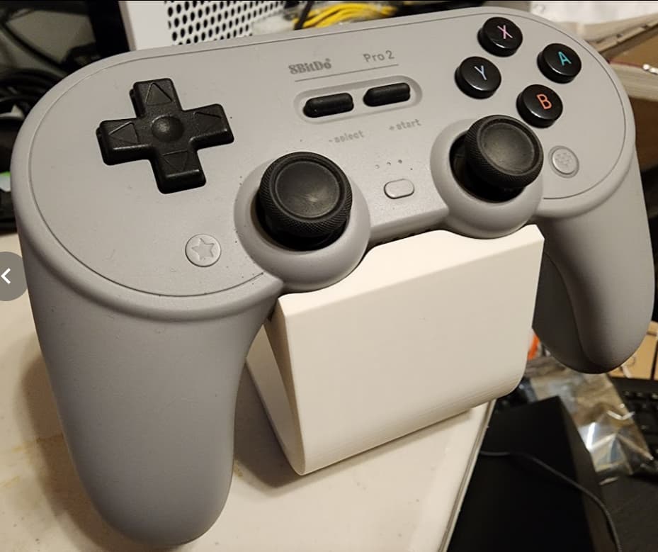

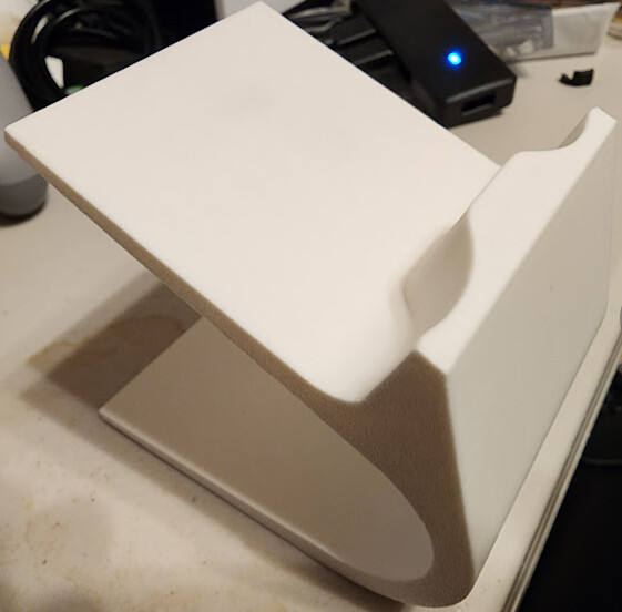

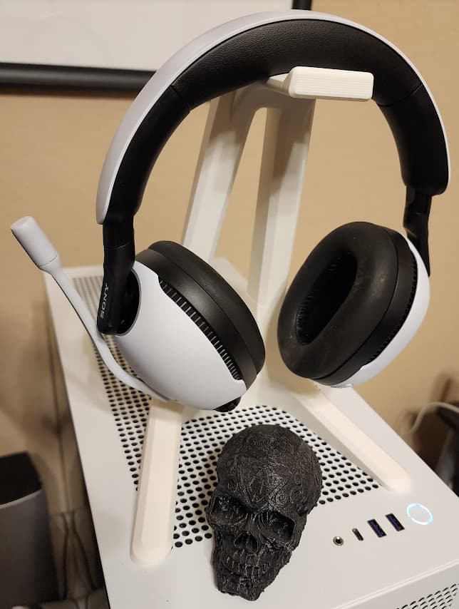

Printed a headphone stand, and 8bitdo controller stand. Matte PLA, turned out as expected.
8bitdo controller stand (fine 0.12 layer):
Headphone stand (0.20 layer):
https://www.printables.com/model/132964-headphone-stand
And for bonus points the skull in the pic (printed a long time ago):

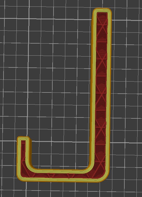

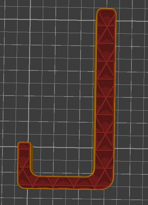

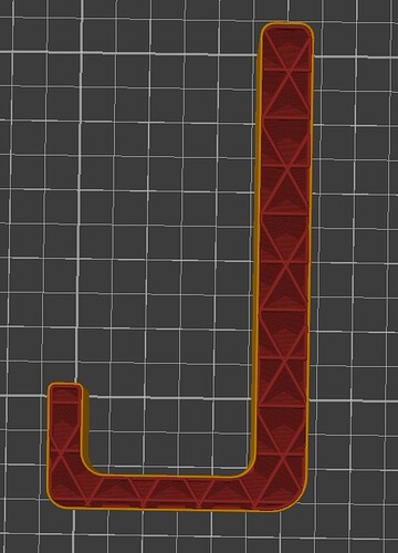

This might be a dumb question, but I’m having a hard time visualizing what changing the wall size does in practice. For example going from 2 to 3 or 3 to 4 walls, what is actually happening? Where is the extra plastic going?
They are getting thicker, which means stronger, eg:
4 walls:
vs 1 wall:
Duh. Into "the walls." :wink: Even I knew that. (Yet can't really answer fully answer your question.) The one thing I think I do know is that walls refer to the sides of your print, the horizontal top and bottom are called layers. My assumption was that thicker walls make for a stronger print, due to more plastic being laid down.
Since the size of the print is set in the design, I also assumed that more wall would mean less in-fill.
OK, @dJOS answered more clearly in about three words and pics. That is NOT fair. :wink:
He-he, experience is good for that.. :sunglasses:
Ah yes this image helps. So I suppose there must be a limit, depending on the underlying design. If you have a thin area, with less infill, then there will be a point at which you can wall no further?
What about if you are doing 100% infill? I suppose number of walls would have no effect?
