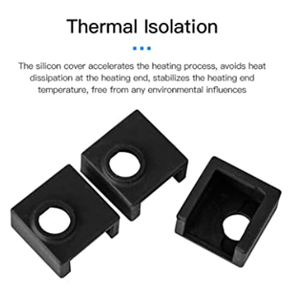

Oh, and is anyone using silicone nozzle covers? Not really necessary, or ?

Definitely recommended. Block cools weird/too fast without insulation. Of course you can get away with it sometimes if you aren't pushing "max speeds" through your setup.
EDIT: Depending on how well aimed your part cooling fan ducts are... If they blow too much on the block it can cause cooling/heating/melting issues too (without insulation on the block).

They are helpful and can decrease the workload on the heater element as it’s not having to fight heat transferring into atmosphere as much.

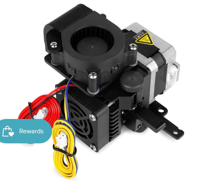

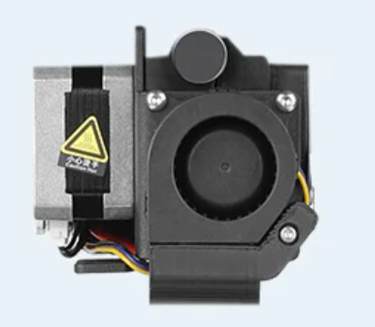

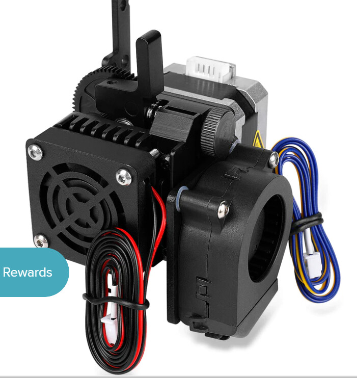

I was looking at the parts pages on the Sovol site and have this extruder listed for the SV04: " SV04 IDEX 3D Printer Metal Direct Drive Extruder" and it looks the same as the SV05 extruder:
SV04:
SVO5:
So SV04 vids on the extruder assembly should be helpful, if not those for the Ender 5.

this looks correct, going to be a couple days before I can get to it though.
I was looking at silicone covers on Amazon, but wasn't sure which ones...presumably the Ender 5 compatible ones should work on the SV05, or ?

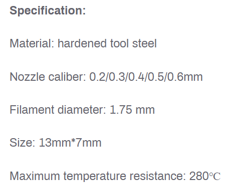

The OEM nozzle sold on the Sovol site has "size" in its spec = 13mm*7mm, but I don't see that level of info elsewhere. How does one determine which nozzles are compatible w/your printer?
That cant be right - no heat block is that small.
just grab some calipers and measure yours, my guess is that it's either identical to a Mk8 (20x20mm or a v6 (23x16mm).

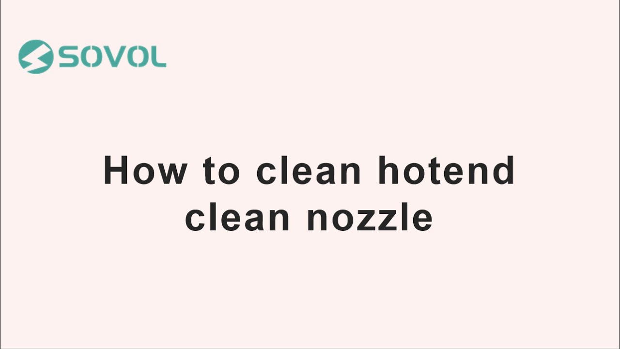

That's a helpful video, but its pace is so rushed for an instruction video...I had to keep stopping it to confirm I got what they were doing at the different steps. Hopefully (for me) when I need to complete that process I'll find a version on YouTube going at a pace that doesn't make me feel like it's a race. :slight_smile:
