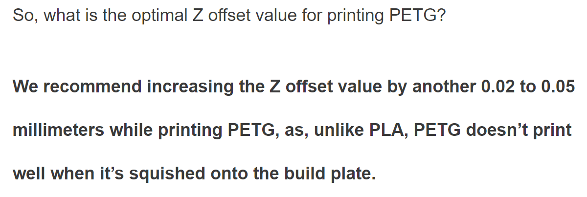

Hard to tell if different sites are just quoting info they found elsewhere but now that I look at Z Offset advice for PETG this seems common:

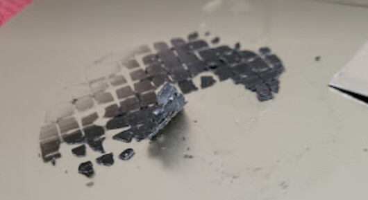

Someone posted this intereseting solution...may try this as a last resort...
PROBLEM: broke off the 3d print supports but the first layer didn't came off with it. I've tried a lot of thing and a knife was really the only thing that worked until this point.
SOLUTION: Print something on top of IT to make IT stick to IT and then remove IT.
  1. Print about 4-layer sheet of PETG on top of the remaining sticked filament (use some ugly one as it's going to be thrown away)
  2. Let it cool off.
  3. Remove the 4-layer printed sheet from the PEI and enjoy the maginc.
  • the sheet removes about 95% of it thought.

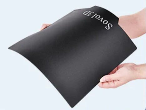

Does the Sovol have a magnetic bed and steel, flexible, textured pei sheet?

The Sovol SV05 comes w/a built-in magnetic bed and flexible build plate like below:
It's not PEI, not sure what it is, frankly. Works well, but not as well as the Creality PEI sheet on metal base worked (until I glued PETG on part of it). :wink:

I usually change the first layer height in my Filament profile to add additional Z-Offset of 0.025. This usually prevents PETG from sticking too well.
