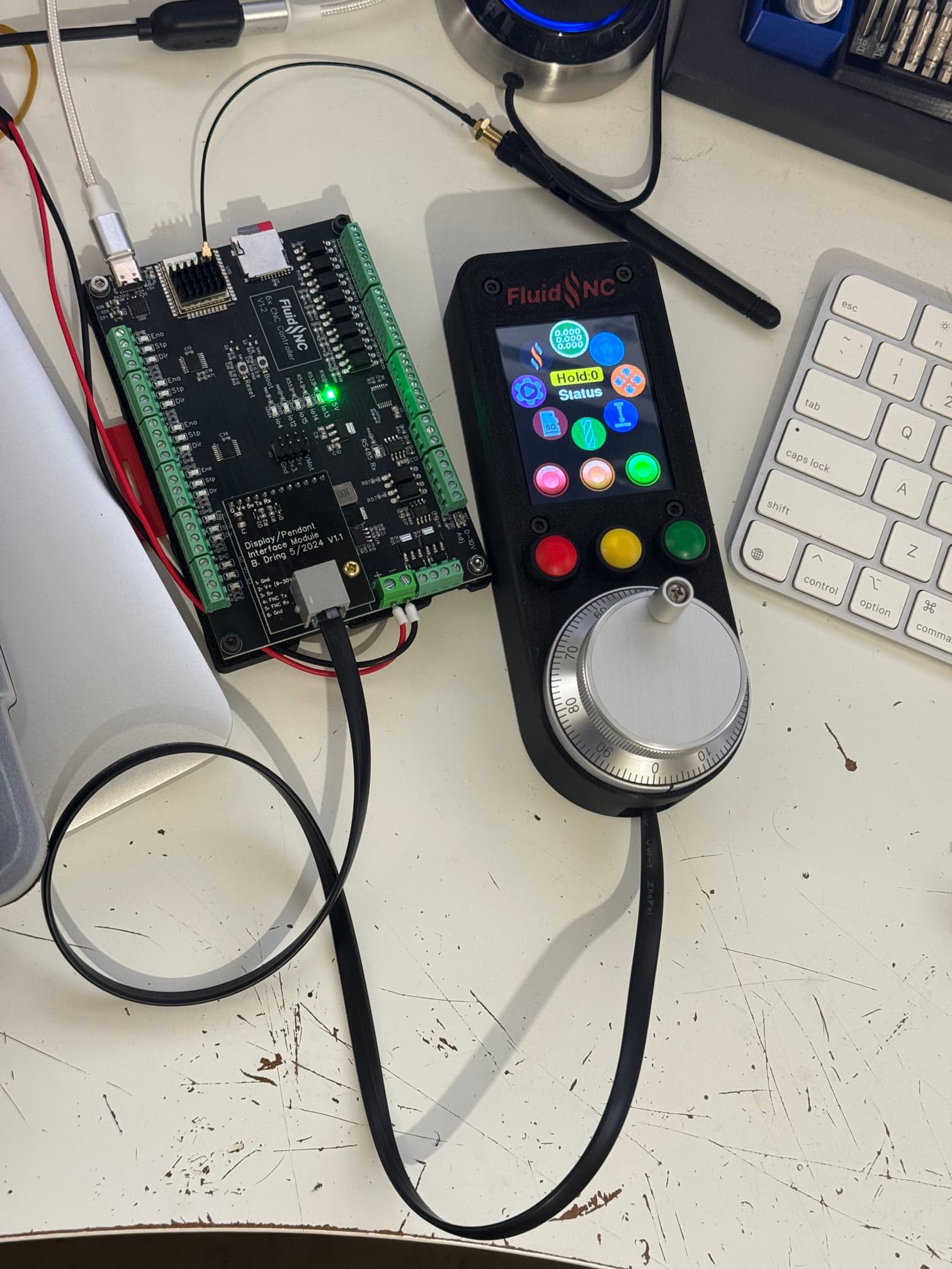

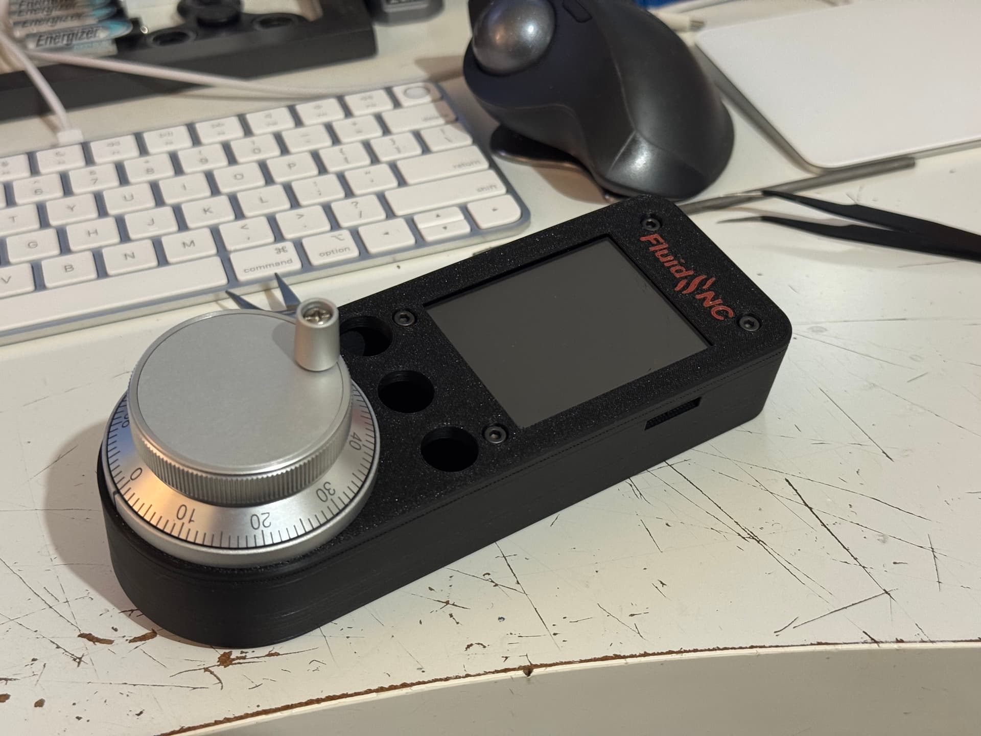

My 3D Printed CYD FluidDial Pendant turned out amazing on the Kobra S1 - having a Filament changer is a total game changer for multi-colour printing!

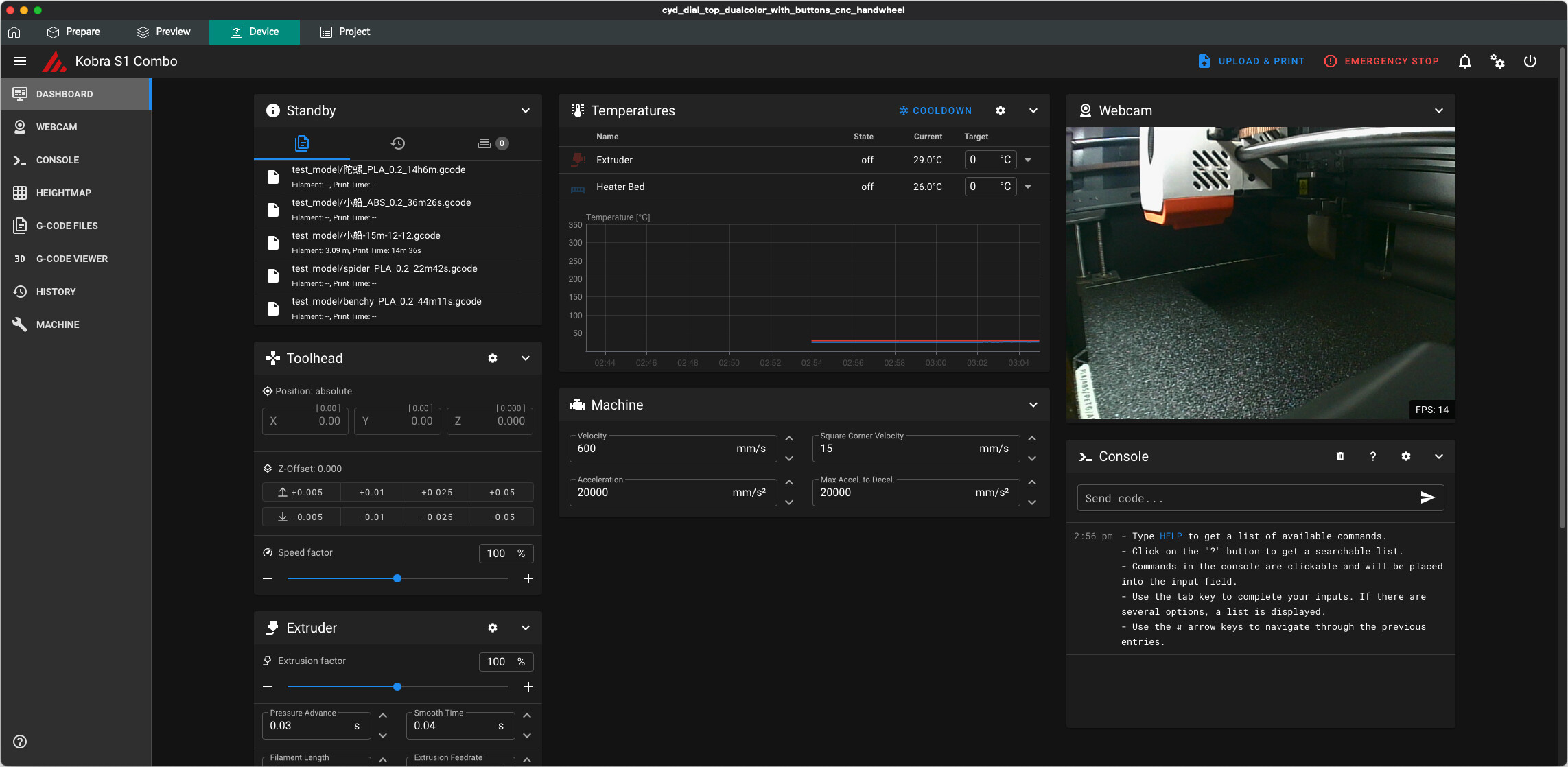

Excellent news for those with a Kobra S1 Combo. With the latest version of the AnyCubic firmware and Rinkhals, you can send jobs straight to the printer, from Orca Slicer, with no stuffing around on the LCD screen!
I just tested it, and it works perfectly!
