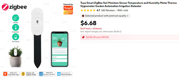

I use Tuya Zigbee sensors from Ali Express for inside plants. They work with the built-in Third Reality Soil Moisture Sensor driver.
Those could maybe be put in the ground at an angle to reduce height? I just like them because they work well and they are very cheap.

These work well with Hubitat and have a decent battery lifespan
https://www.aliexpress.com/item/1005005083140791.html?spm=a2g0o.order_list.order_list_main.171.777c1802BNK8e4
