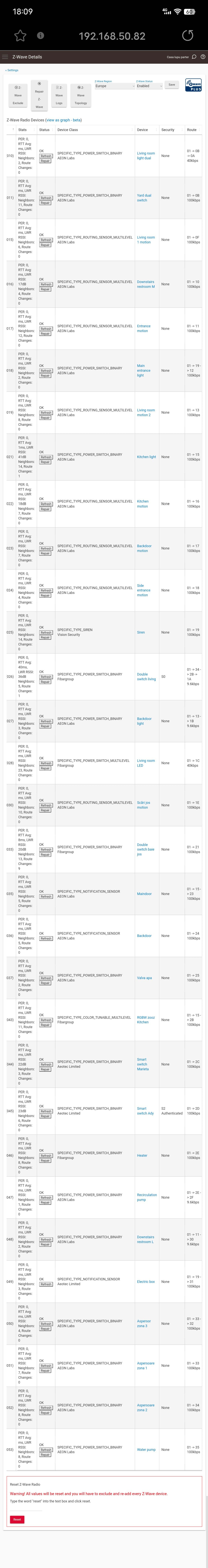

For example, you have not posted your entire z-wave details page. Just from the snippet you posted, it is clear there are additional devices (eg. 0x19). And from your response to @jtp10181, we learned there are probably additional Fibaro devices that aren't shown on that list.

because the list is too long to go in one snip, i can tell you there are no ghost devices and most devices have good signal, I have antennas on my c7 for zwave, i provided vpn access to jtp10181 now and we'll see if he can find anything.

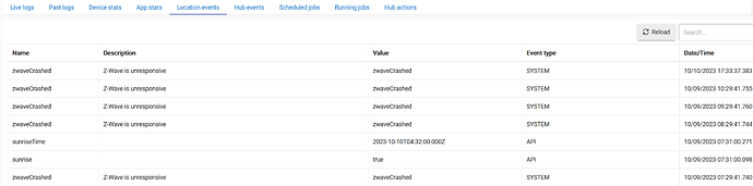

Also I noticed lots of zwave crashes in logs, i will check if they happen while running 2.3.5 too, but keep in mind i can still control devices from dashboard instantly

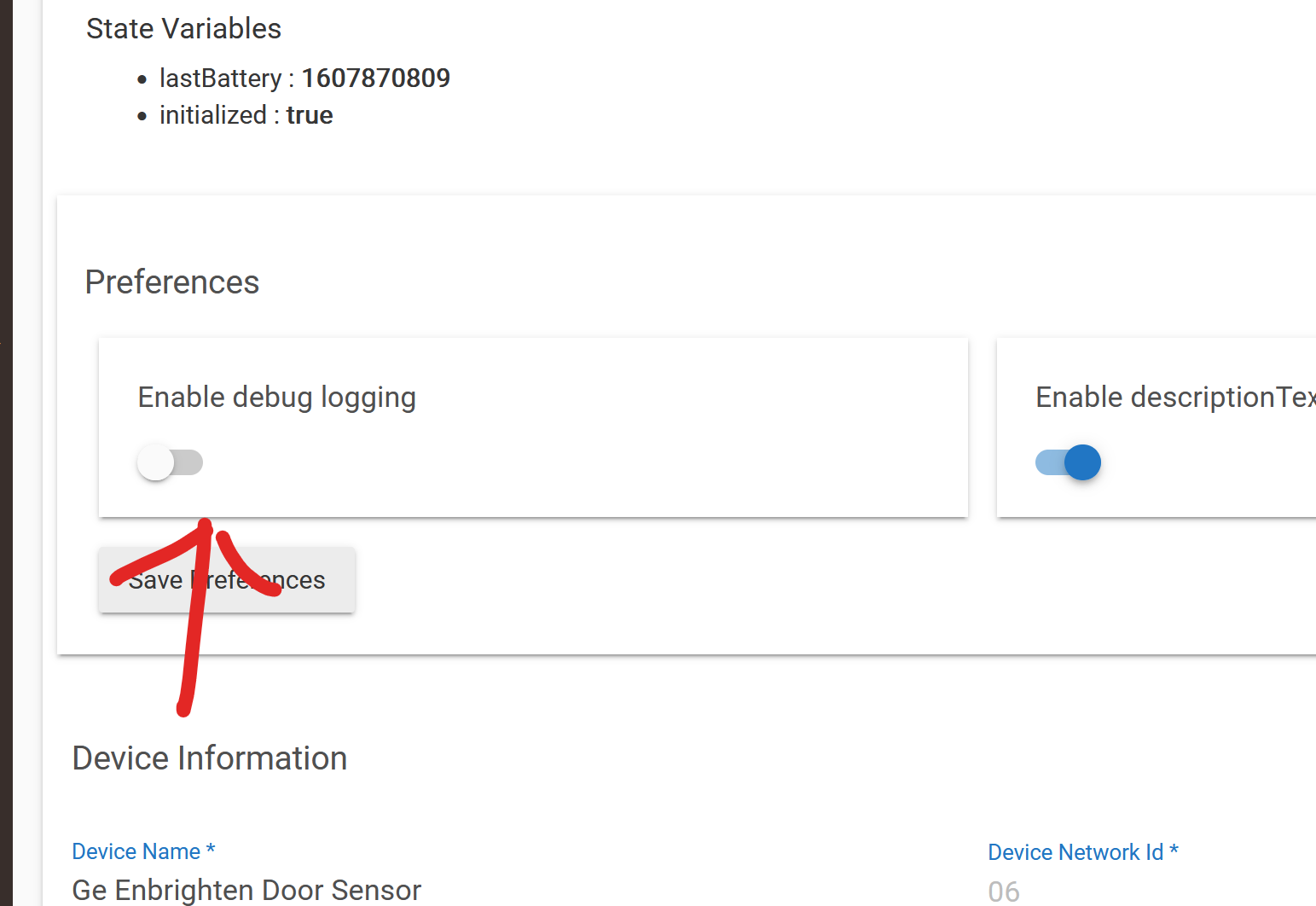

The fact that your z-wave radio is crashing indicates either a bad radio or a bad device Finding it is the key. You're gonna have to turn on debug logs. I also don't know how you can do everything on a phone... would hurt my brain lol.
What debug logs, I already removed 1 motion sensor who i saw being the last one to report when the bug happens most of the time, could be a coincidence but will find out soon .

Yeah I see the Zwave crashing is coinciding with when the events from the sensors stop coming in. Good catch, I always forget to look at that log tab. You will need to power down the hub for 10+ seconds and restart to make sure the zwave radio restarts, Then test further and see if the crash happens after any specific devices report in.

Based on your hub's engineering logs that only go back to 9/7, you've had at least 10-15 crashes every day. since. The 2.3.6 update came out on 9/20, so the problems you are having started long before 2.3.6. You are dealing with a problem that can be solved by eliminating devices that may cause the radio to crash, or simply your radio is bad and the hub needs to be replaced.
