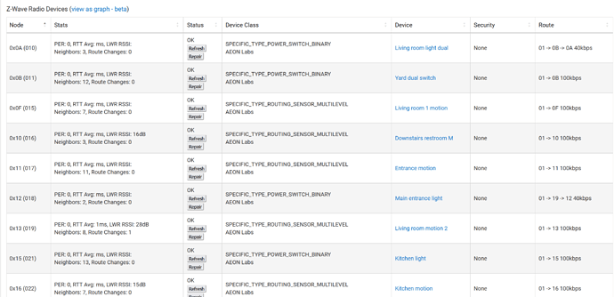

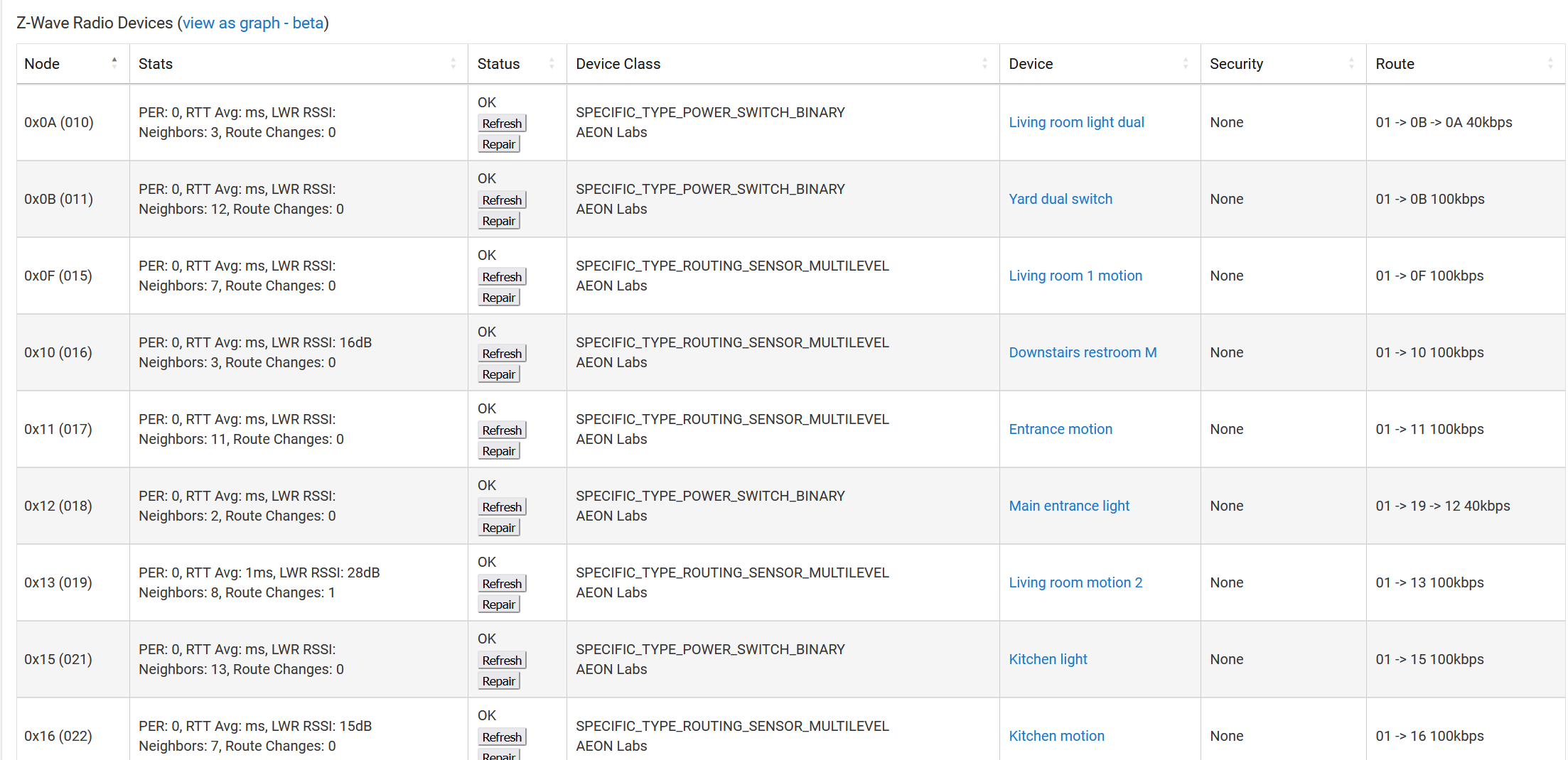

Can you post a screenshot of your entire z-wave settings page?

Is that all your zwave devices? How long was the hub running when you took that screenshot?

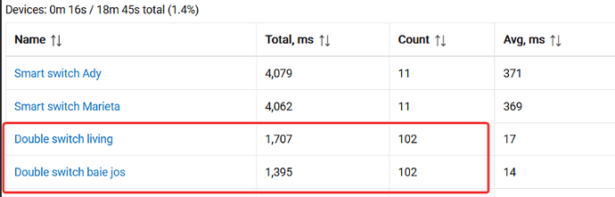

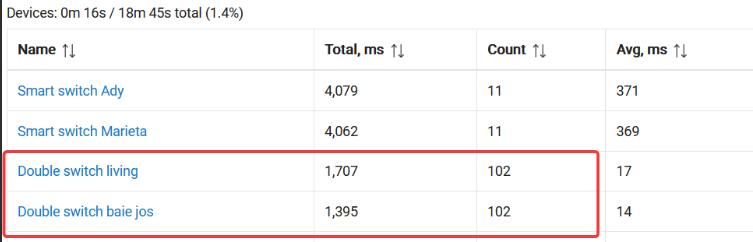

Also are these z-wave (below)? Seems like a lot of events for 18 minutes of uptime

Those fibaro switches with lots of events have a firmware bug that doesn't allow me to disable their power reports, they are one of the reason I went with 2 hubs instead of 1 in my house.
