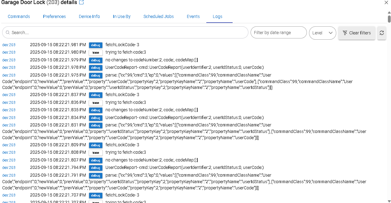

Trying to add a new Kwikset 620 lock to my C8 hub. Read through the forums first, saw that you needed hub to be close and to use S2 security. Moved my hub to within a few inches of the lock and used S2 security. Lock added fine, but now my logs are going CRAZY. It never stops searching for user codes... if I send a lock command it'll lock, but sometimes it takes 15 or 20 minutes to do so.

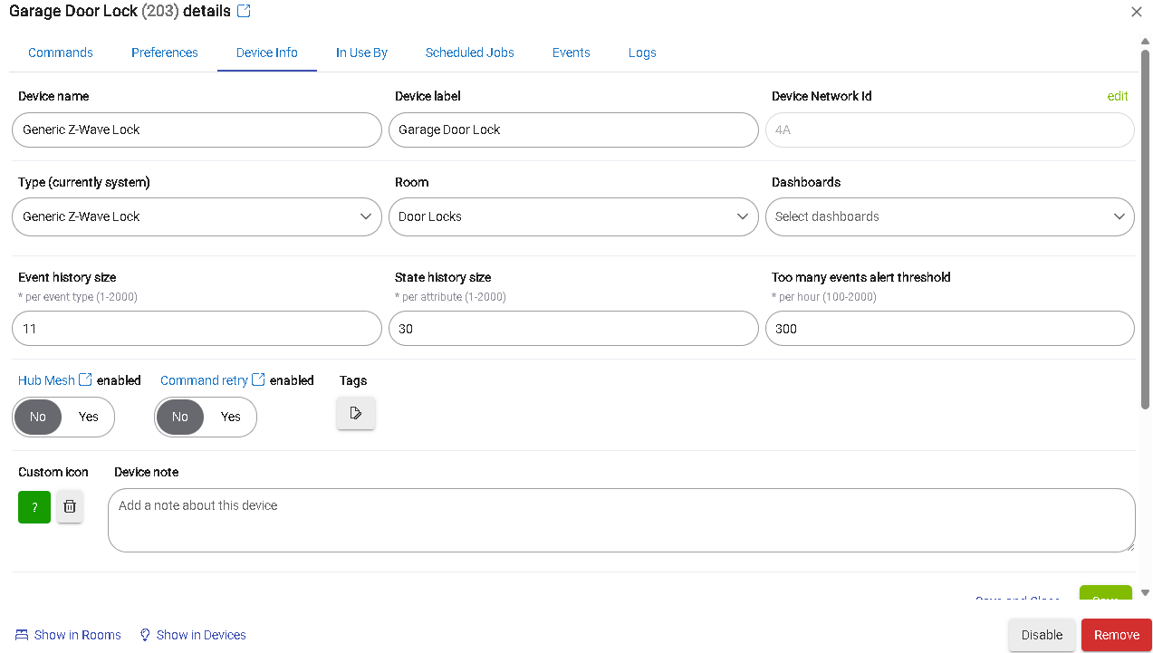

I've tried 10 times now, I tried without security and it still added as a device but nothing happened after that. The device always recognizes itself as a "Generic Z-Wave Lock". When I click "Configure" sometimes I see the command in the log, sometimes I do not, but I do not notice anything different. For reference, my last attempt to add was about 10 minutes ago, device added, and the logs are still scrolling a mile a minute with the:
debug
fetchLockCode- 4
trace
trying to fetch code: 4
debug
no changes to codeNumber:3, code:, codeMap:[:]
Logs:
Device Page:
Log on different attempt:

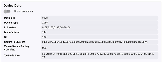

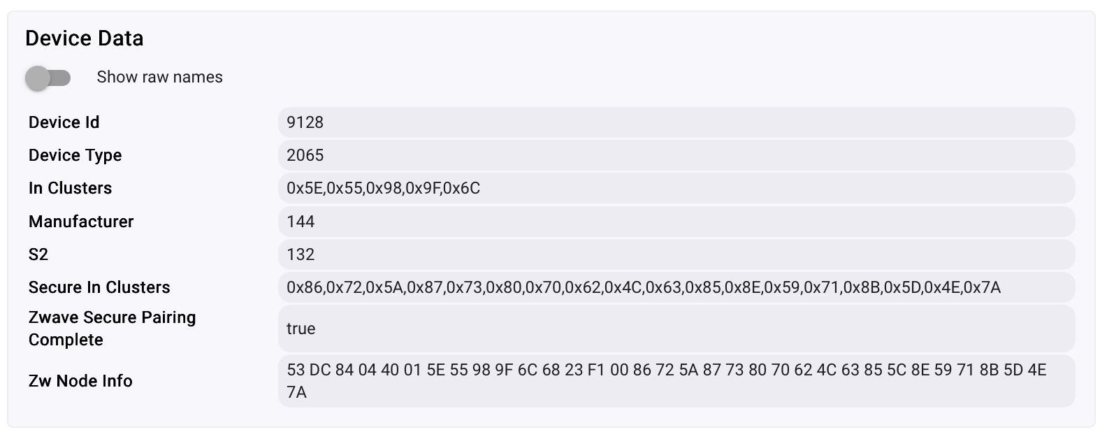

I have five of these locks. I had them on a C-8, and now they're on a C-8 Pro. The lock has to be paired with S2 security. Never had an issue with any of them, so your lock also should work. I have a few questions:
  1. How many Z-Wave devices do you have paired?
  2. How many of these are Z-Wave Repeaters?
  3. Any Z-Wave ghosts or stranded devices?
  4. Can you post a screen shot of the lock's device data. For comparison, here's the device data from one of my locks:

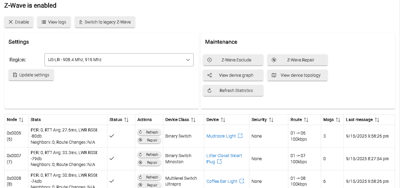

Hub mesh has nothing to do with Z-Wave or Zigbee mesh networks. Please post screenshots of your z-wave settings page.

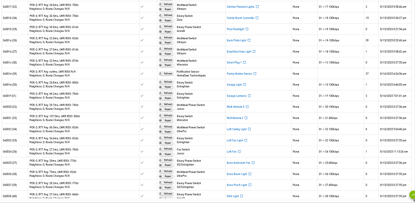

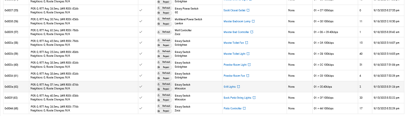

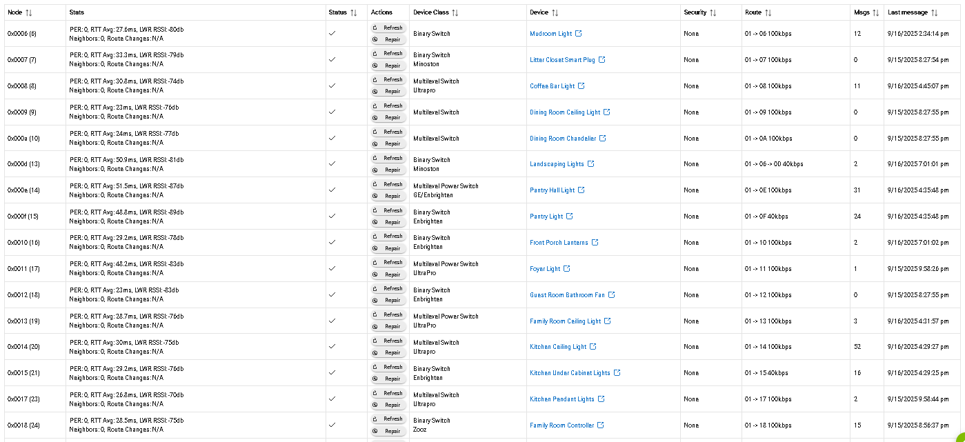

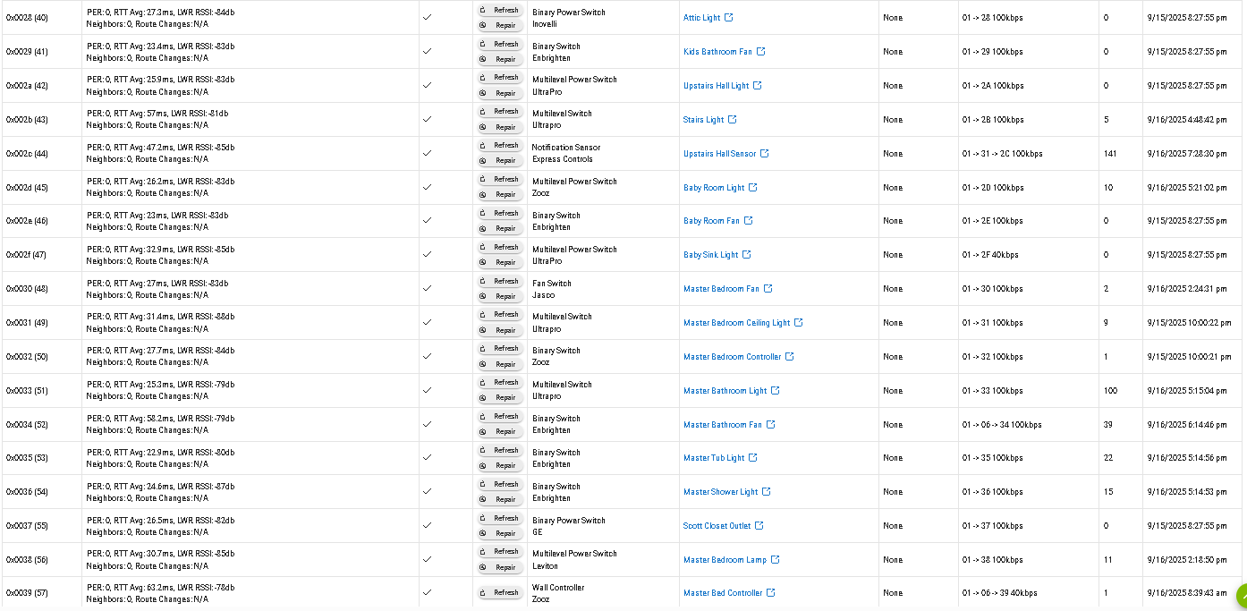

Yes. That page. Please post the entire page. It might take multiple screenshots.

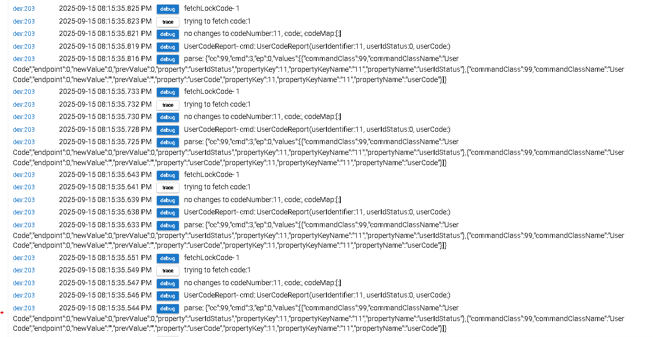

Lock gets laggy because it is busy with errors fetching lock codes. The hub will report a high load after a bit. Do not use the get codes function. Once that get - fail -get loop starts the only way out I have found is to reboot the hub. I was told there is a fix in the works. But you can run the zip version of zwave as that does not have the issue.
There is a fix for this it’s in beta about to be released
attached are the z-wave screenshots
i have no way to stop the fetch lock codes - as soon as the device connects it does that, and if i wait for it to finish then try to lock the lock, it starts fetching again.

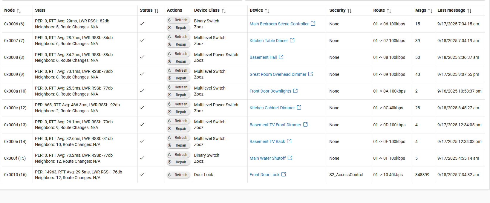

Chiming in here because i was about to post a very similar thread. My 620 has been hogging my entire network trying to fetch codes. Lock paired easily quickly about 6 hrs ago. It's only up to code 21 out of 250. Logs (regular and Z-wave) are going CRAZY and no other commands seem to get through reliably.
More context: I just wiped my C-8 Pro and nuked my Z-Wave last night. This is only the 6th device i've added on basically a fresh device.
@bcopeland I'd love to jump in on that Beta too!
24 hours after adding my 620:
  • ~849k messages
  • 23 codes processed
