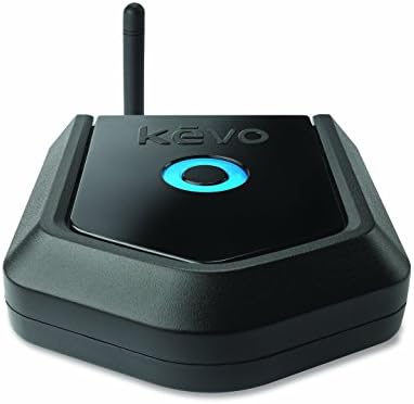

curious if it would be possible to control one of these with hubitat at some point in the future?
Nope. KEVO has a closed API
