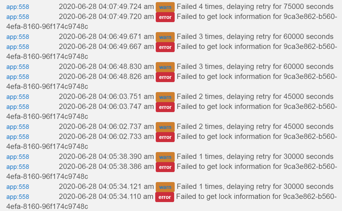

@dman2306, seeing an occasional odd problem with your Kevo Plus Integration, like this one early this morning:
That went on (with the "75000 seconds" delay) until a little after 4:30 am, when it suddenly stopped, and is working fine now.
Unfortunately, that just means the Kevo servers were down. Their servers unfortunately seem to go down a bunch at night. The log message is wrong though, I need to modify it. It is waiting 75000 MILLIseconds, not seconds.
