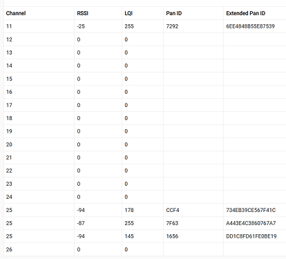

This is my channel scan on the C-8 Pro
CH 25 is my Hue Hub.
This is my channel scan on the C-7 (Which is on CH26 because I have no real devices on it) but I don't know why it reports 0.
So the C-8 sees itself at -64 RSSI which is considered fair.
The C-7 which is about 50ft away sees channel 11 with an RSSI of -25 which is excellent.
So it does not make sense to me so I must misunderstand what this is telling me.
I'm not sure about trusting the channel scan feature...it's had a history of some strange results...@tony had some comments on it here:
I think the Hue bridge can live about wherever you want it to, I've moved it around to different Zigbee channels and it never seemed to care. So I'd prioritize the C8 (which seems to be pickier) and then give the Hue bridge the left-overs. :slight_smile:
