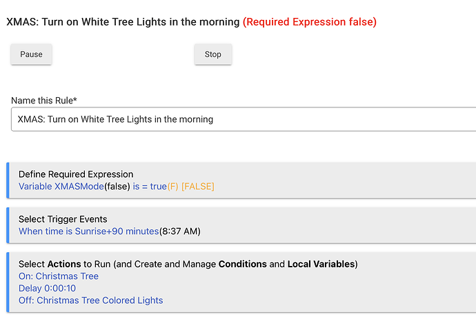

OK. I too have been experiencing all manners of weirdness. BUT, I have figured out that this release, 2.4.3.127, on my HE 8 Pro caused all STOPped rules to start up. So, various debugging/seasonal/debugging/testing rules are running. In particular I have about a dozen "XMAS: Do this decorative thing" type rules that are running. Taking out the trash and seeing the lovely green and red porch lights did it for me.
So, yes like a previous release some time back, 2.4.3.127 turns on STOPped and maybe PAUSED rules too.

Awesome. Thanks Victor. Meanwhile I added a required expression to all of these rules that I've relied upon STOPping so this doesn't bite me again. For anyone wondering how to do this, I created a Hub Variable called XMASMode and set it to False for now. Then modified each of these rules like this:
