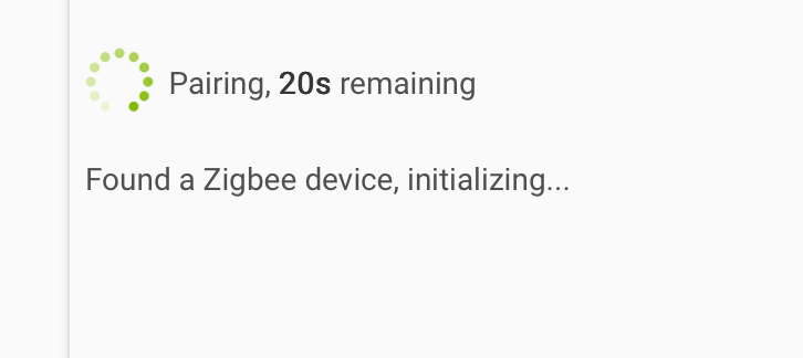

I’m trying to add a Mini Human Breathe Sensor (Model: ZY-M100-24G, ZigBee) to my Hubitat hub, but it consistently gets stuck on the “initializing” phase.
Here’s what I’ve tried so far:
- Standard pairing mode
- Pairing while exchanging keys in clear
- Pairing while avoiding ZigBee 3.0 repeaters
- Power cycling the hub (via Settings > Shutdown, then unplugging)
- Bringing the sensor close to the hub and also close to a ZigBee repeater
Each time, the hub finds the device with a “ZigBee device found: initializing” message, stays there for about 40–50 seconds, and then times out. After that, it says “finishing up, please wait” and eventually errors out.

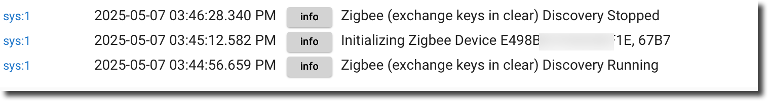

Logs just show that ZigBee discovery starts, the device is found, attempts to initialize, and then discovery ends. I have two of these sensors, and both behave the same way.
Any ideas on how to get these sensors past the initializing phase and added successfully would be greatly appreciated!
