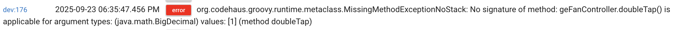

I was hoping with all the Zwave JS work in the latest release 2.4.3.122 that my GE Jasco Fan controllers double tap function would now work. I guess not, it is still not working. I get no log entries when physically double tapped and get this error when I run a double tap command from the devices page.
