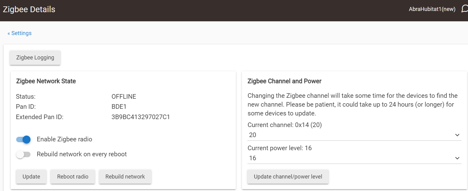

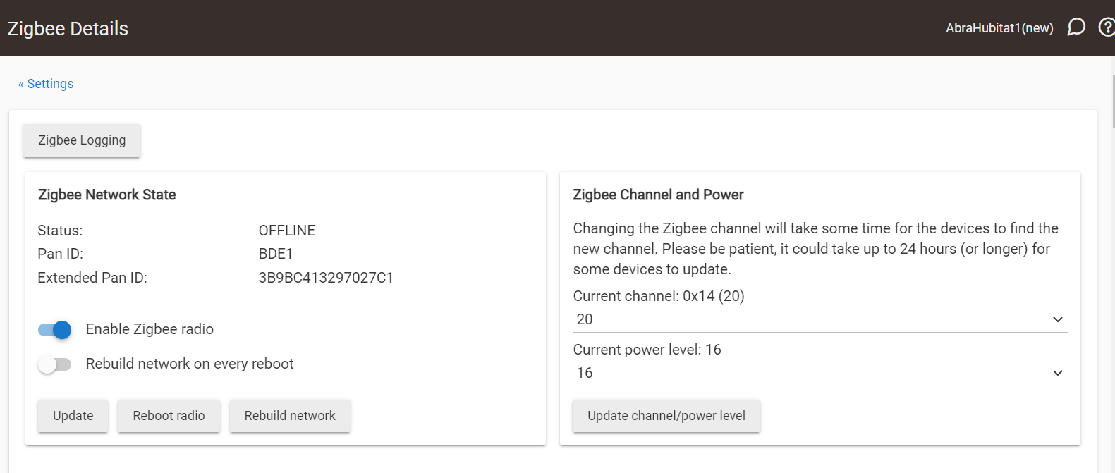

Count me in on having the Zigbee offline/online issue, most gracious sir. Details posted most recently here:

Devices dropping off may be the side effect of Zigbee going offline frequently. As @gopher.ny mentioned a few days ago, your specific case is still under investigation. We will follow up on your private message when we have an update. But if you don't hear back, don't hesitate to ping us, we get lots of PMs so it's easy to miss one or two.
