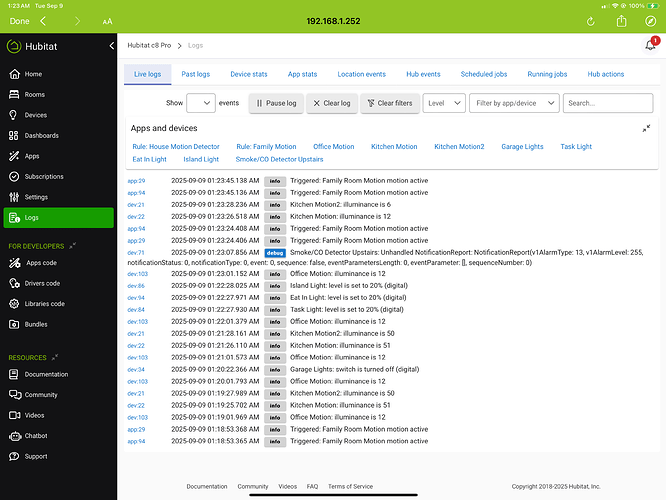

Is this debug report a problem?
So I get this debug message from my Smoke/CO sensor. Is it something that needs addressed?
Bumping. It doesn't seem to cause a problem. I just noticed it in the logs. Then again, my smoke/CO detectors aren't activated often than goodness.

It’s First Alert smoke/CO detector and zwave. It is a battery device. I’m on a C8pro with the 2.4.2.158. I have two of these detectors and both report the same debug message. I’m using the universal smoke/CO detector driver.

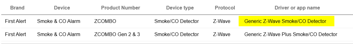

Ok that's the older original ZCOMBO unit. My driver was built on a more modern ZCOMBO-G unit which uses a newer more standardized messaging protocol.
Info here: Z-Wave JS Config DB Browser
Alarm 13 is smoke idle according to those docs.
I am not totally sure if my driver will even pick up a smoke alert from that thing. Have you tested it on that driver? If not I would suggest doing so to confirm if that driver even picks up the alarms.
Since it does not even have command class 0x5E I assume it is not even Zwave Plus, and thus you may need to use this built in driver in order for it to work correctly.
It has worked in the past when cooking bacon but I think I’ve since updated the driver. I can’t leave well enough alone. I think I should go back to the old driver. Any guidance?
I updated both to the “ Generic Z-Wave Smoke/CO Detector”. Good enough?
Yes that should be the correct one which I stated above. You can watch the logs for any more errors. I would also run a test cycle on it when you can, with debug logging enabled on the driver, and make sure the hub picks it up.
