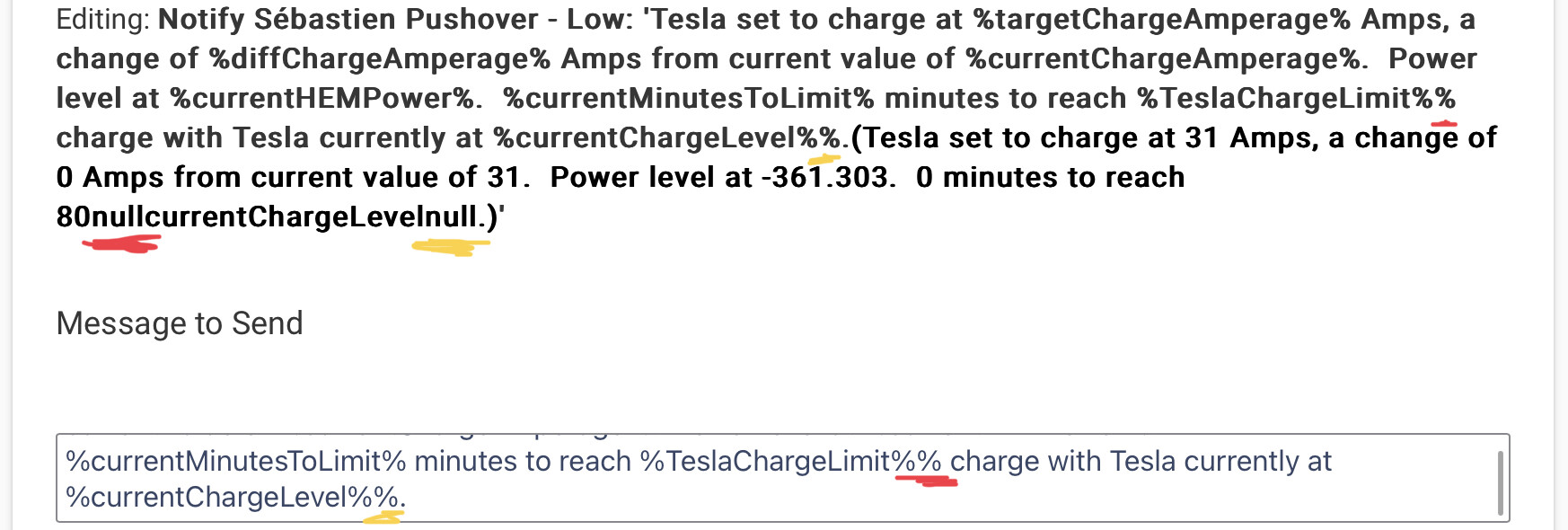

I found this old post with issues with the %, they found it worked if they used a variable. So maybe try making a variable with just the < in it, then use the variable in the notification?

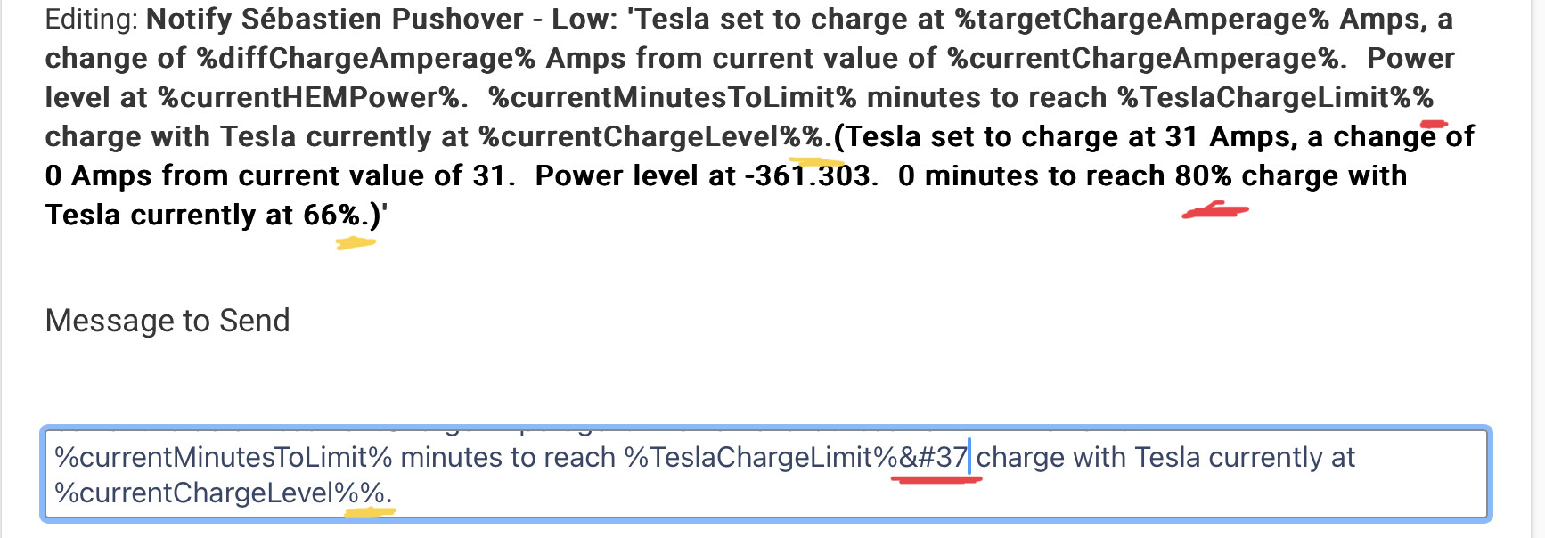

I can't write it exactly in this reply as it gets converted by the forum, but this works for me on an iphone text
ampersand numbersign 62 semicolon for >
ampersand numbersign 60 semicolon for <
ampersand numbersign 37 semicolon for %
&#62;
&#60;
&#37;

My assumption has been using Rule Machine to send a notification to your phone. Yes, Rule machine will convert the keyboard sequences into their respective characters - BUT it comes over correctly to my iPhone. I don't know about Android. Using
&#62; for >
&#60; for <
&#37; for %
