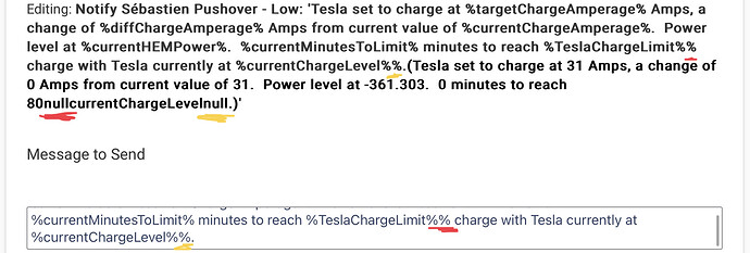

Using “%” character in notification within RM?
Wondering if anyone knows of a better way to do this.

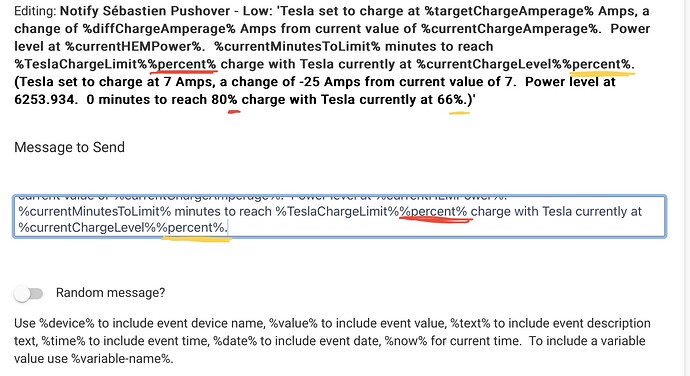

I am trying to use a “%” character in 2 spots within a notification. This is not working because it is set to recognize %variable% and convert this value to the variable’s value. This leads to (First % underlined in red. Second % underlined in yellow):

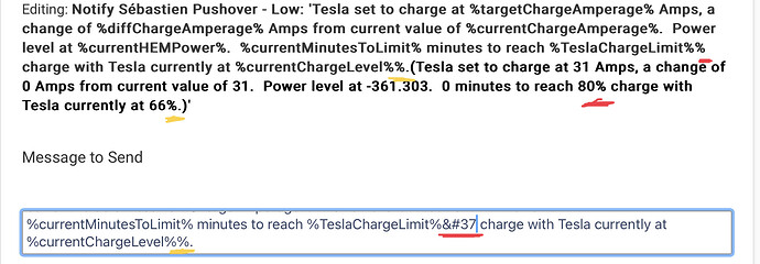

I first tried to replace the first “%” character with &#37, but this got automatically replaced with the above screenshot after leaving the message edit box:

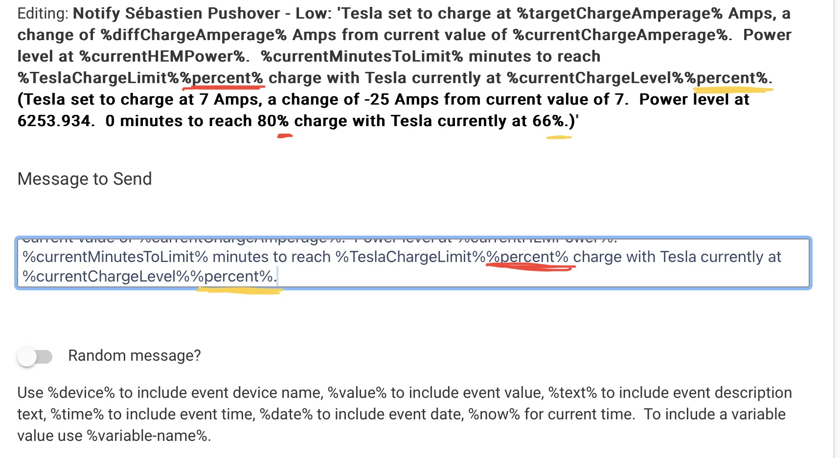

I ended up placing the “%” character in a string variable which I added to the Message box and this worked. However, I wonder if this is the best approach. Does anyone know of another way to do this that wouldn’t require an extra variable?
Here is a screenshot of the approach that works:

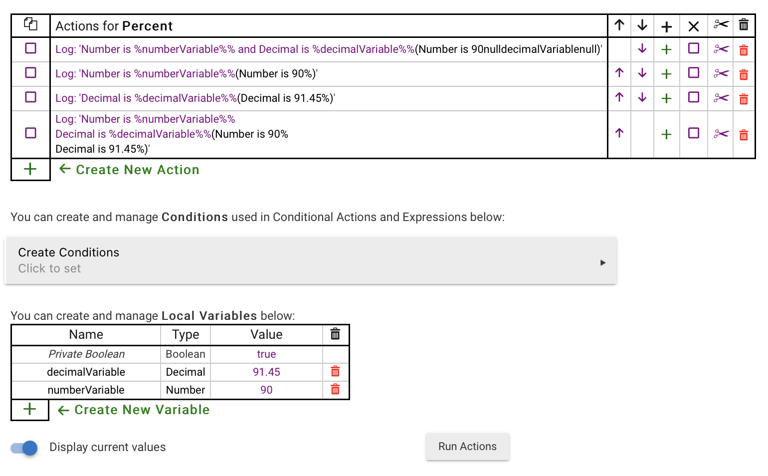

I can reproduce this issue. I just made a simple rule to write to the Log as shown below.

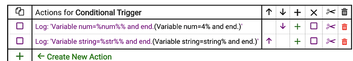

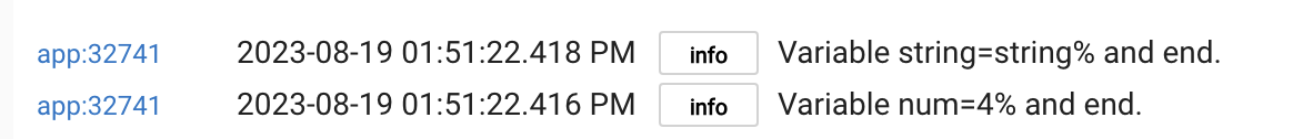

I have no problem with this. This rule:
produces these logs:
Looking at @aaiyar's example above, the first case is certainly going to fail as the code will interpret the second % as matching the one after that, looking for " and Decimal is". That's a pretty narrow edge case, not worth wasting any effort on.
Exactly. It works when there is only one % after the last variable. The workaround of using a variable to store the % works for those edge cases.
