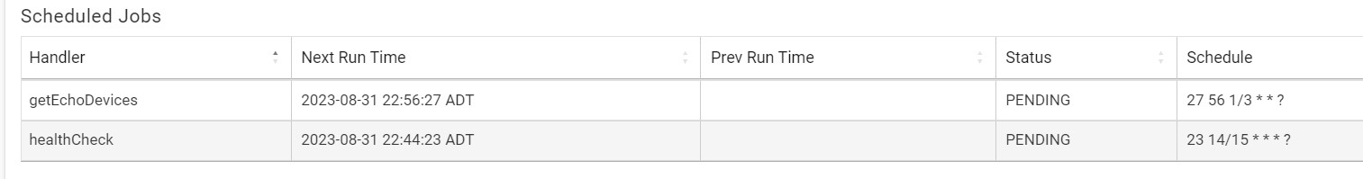

Interesting getting devices is pending. No idea why.
