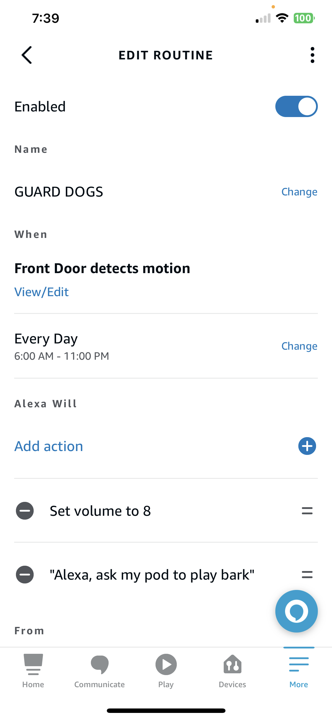

ok. I am not an expert at this but that was easy and works. Here is a screenshot of how to setup Alexa routine. Let me know how it goes.
Thank you! I will look now.
