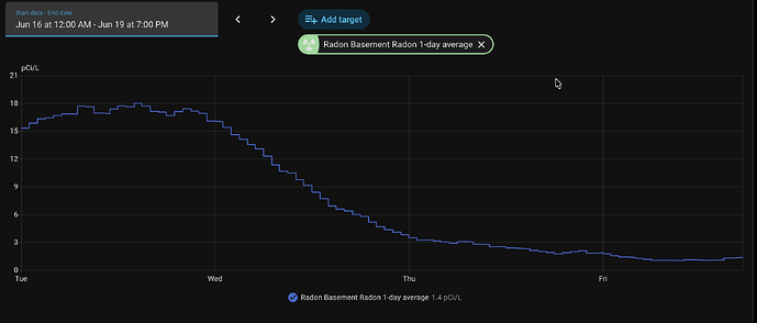

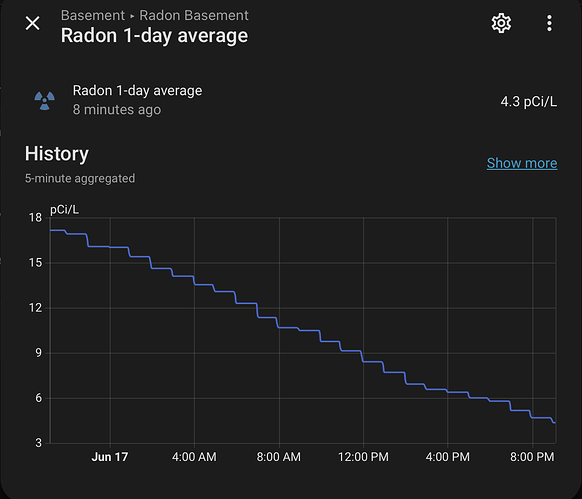

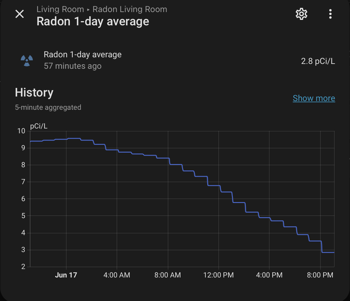

Without posting the charts, yet anyway, let me just say the fan makes a big difference, even now in summer, in both basement and upstairs. It’s been cool the past several days though, and the windows are closed. Plugged it back in.

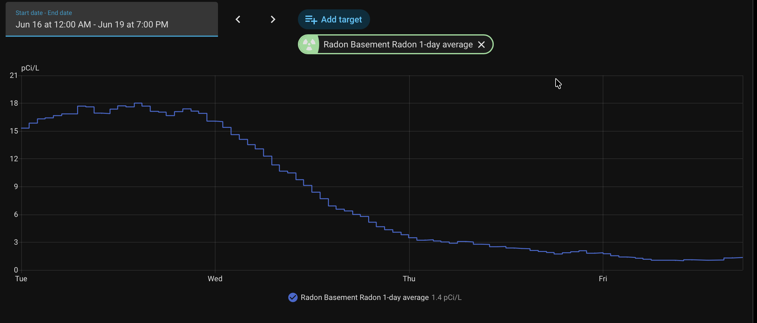

The radon fan makes a big difference:
I am really happy with the performance of the radon fan.
Did I need three detectors? No.
Would I sell two of them? Yes. :slight_smile:

I turned off the fan to see how high it would get.
It got pretty high. :slight_smile:
