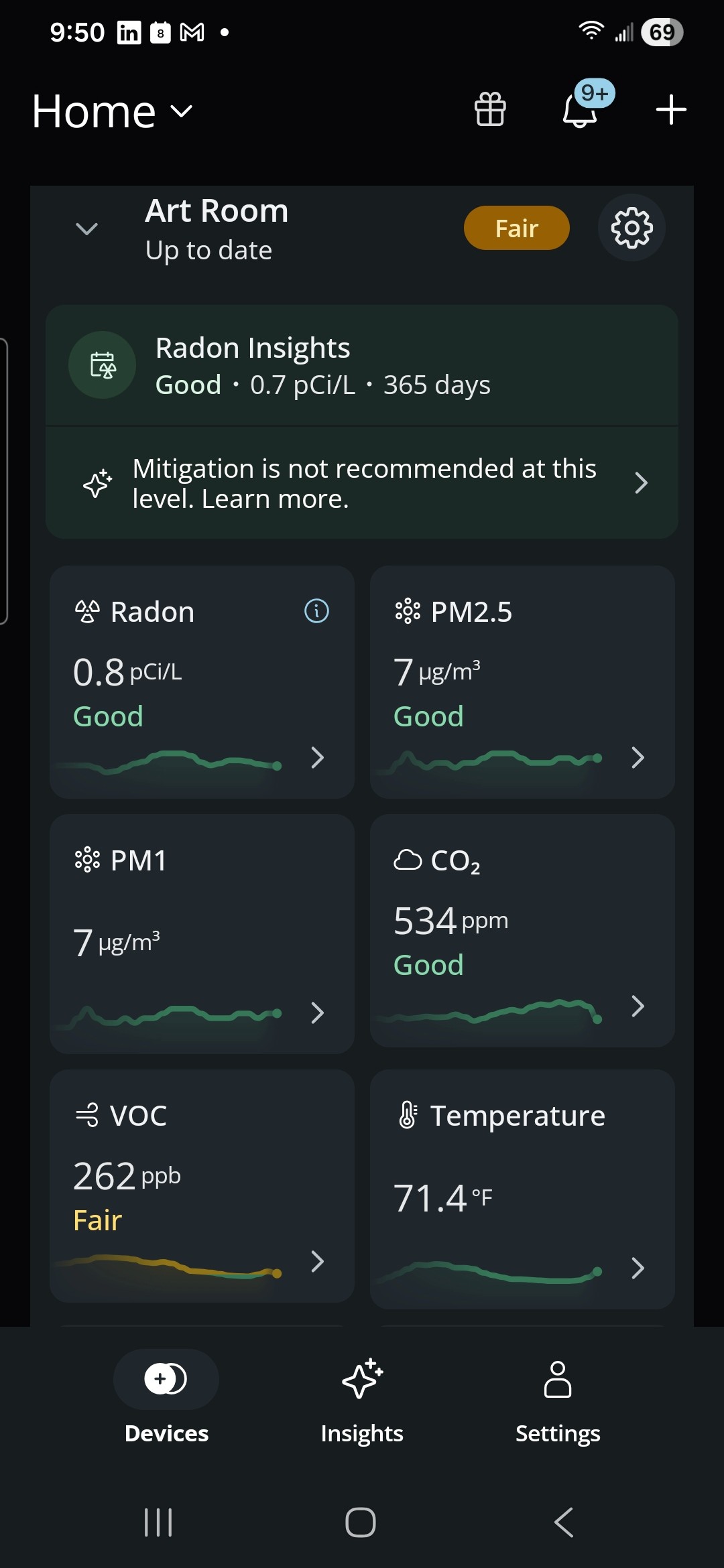

I use this, and it works well - It’s cloud based, but I only get updates every 20 mins or so.. - The AirthingsView Plus monitors alot, I purchased it for Radon measurements in my basement, but they are consistently low, and now I focus on using VOC measurements in a art studio (in said basement) to turn on an exhaust fan.
It does the usual Temp, CO2, Humid - But the PM measurements are mildly interesting, and it even registered higher than normal particulates when we had a local forest fire, it a national forest around 10 miles away.
So the Airthings view is not the cheapest device, but it measures alot of valuable Air Quality data, over the long term, and the “near real time” Radon and VOC measurements are the major draws for me. - I just wish it natively supported Matter or MQTT, but it is what it is. Not sure if the cloud connection is a show stopper, but it’s just a monitoring tool, that has been well behaved for me over 2+ years now.

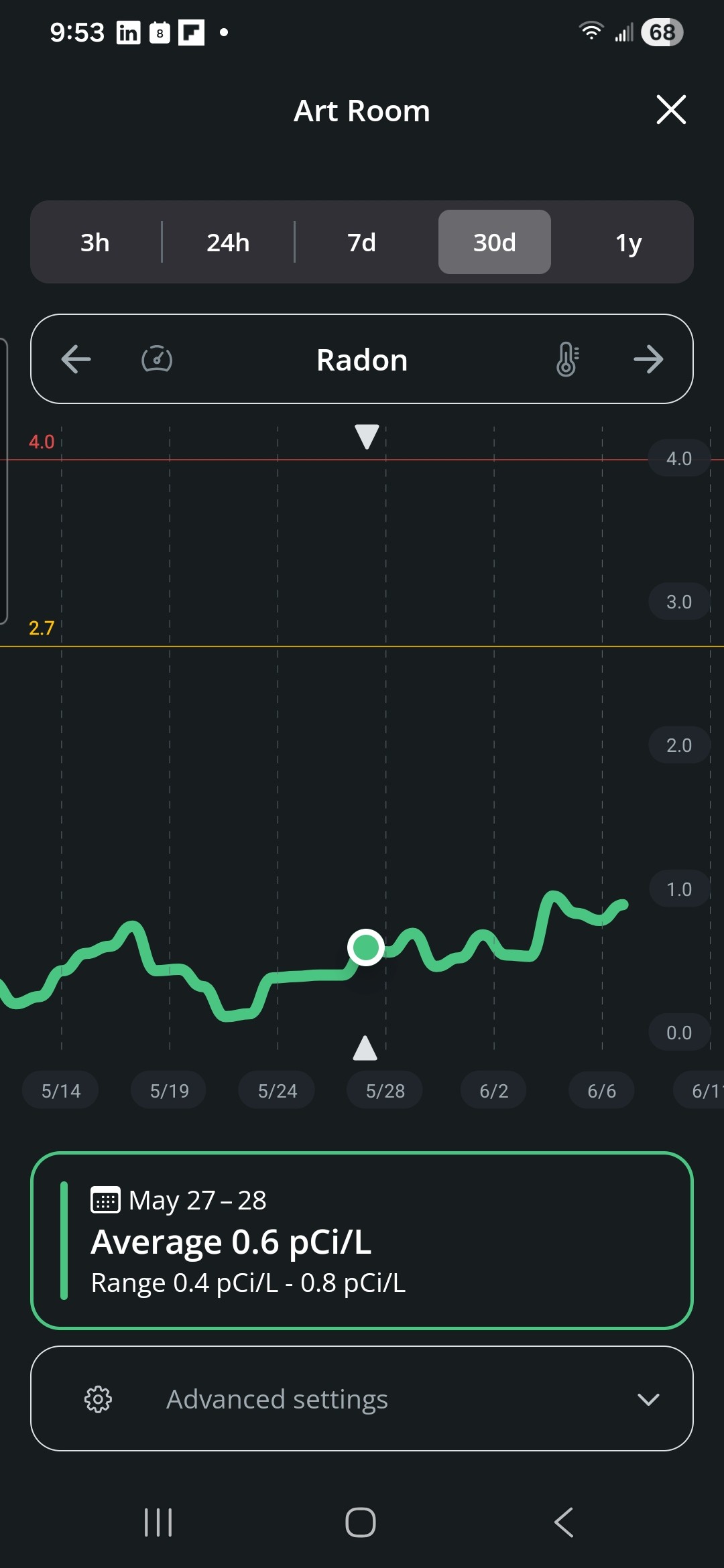

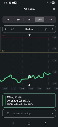

Having multi-year graphs of Radon for a basement, is definitely a plus when trying to sell, and get past home inspection requirements. - Images attached for 30 days of Radon measures (it stores a year of data on their cloud), and Overview of all measures - They also send me a weekly “summary” of anything that looks abnormal. My wife works in the studio, 6-8 hrs a day, so the extra data and visibility is worth it to me.

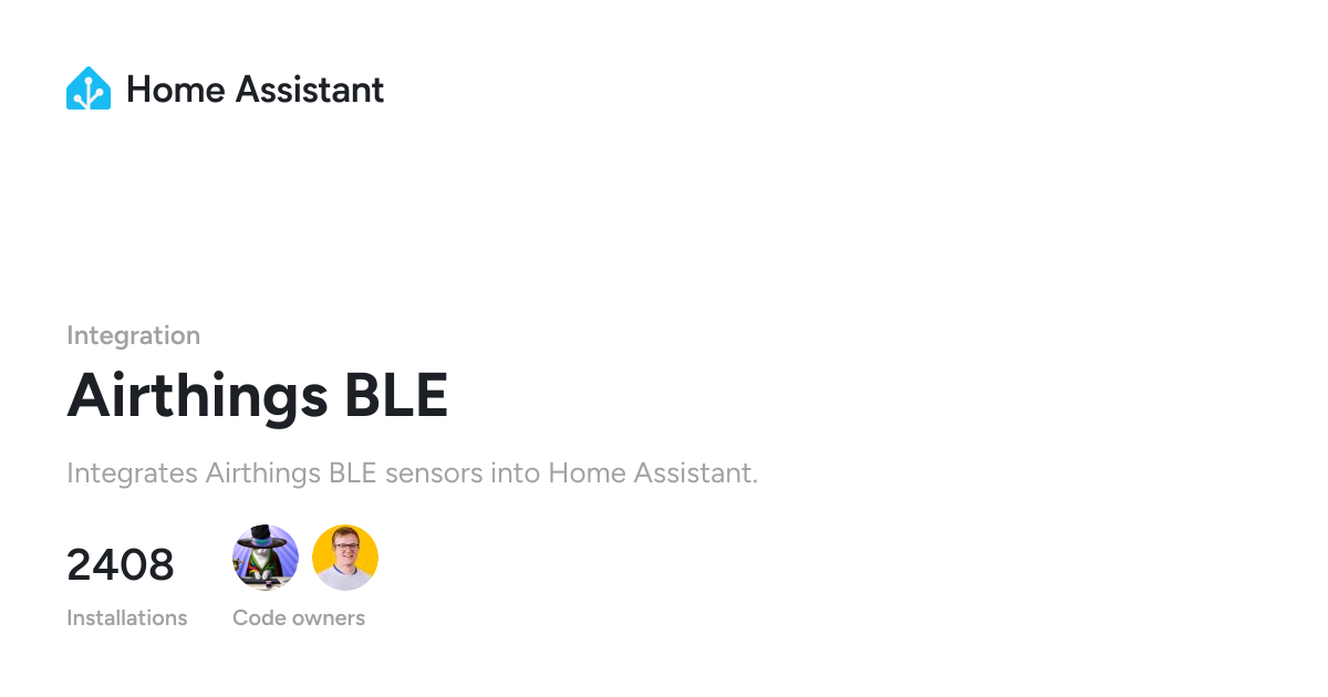

There appears to be an HA integration for AirThings bluetooth sensors.

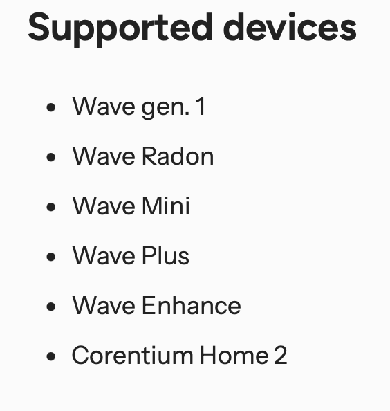

I’m gonna give the Wave Radon a whirl.
Should be local with HA.
