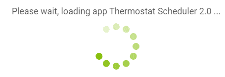

I have been struggling to get Thermostat Scheduler to reliably control my Thermostat. In a separate thread I documented my efforts to try various Hubitat versions and have concluded that there is a problem with versions above 2.3.4.140. In exploring the issue, I loaded 2.3.4.151, confirmed the problem, and then reverted to 2.3.4.140, only to discover that I am no longer able to invoke the Thermostat Scheduler -- it just spins and spins. I tried rebooting (and also powering down) the hub, and ultimately deleted the Thermostat Scheduler app. I apparently shot myself in the foot as I am now unable to reload it -- just spins and spins. Is the app corrupted? How can I get a good version? Would attempting to restore from a backup be advisable, or might this cause other problems? Help!

For lack of a better idea, I reverted once again to 2.3.4.140 in hopes of getting back to a version that worked. Unfortunately, I am now back to the continually spinning wait for the Thermostat Scheduler to load:
Must certainly have something corrupted. Will restoring from yesterday's back do any good? Will explore further in the morning....

Before going to bed last night, as reported, I reverted back to 2.3.4.140 and encountered the spinning symbol when attempting to view the Thermostat Scheduler app. It was still spinning this morning when I attempted to see what had happened to the Thermostat Scheduler temperature schedule when viewing the Hubitat as a device on my WiFi network. However, I discovered that if I accessed my Hubitat via the Remote Access, I could select the Thermostat Scheduler app and get it to display without any spinning symbol -- very strange -- maybe something caused by reverting to a previous version when the scheduler had been updated? I went for my morning walk and returned to the house after 6:00 and find the house warming to 66 degrees, as desired. The Thermostat Events log shows:
