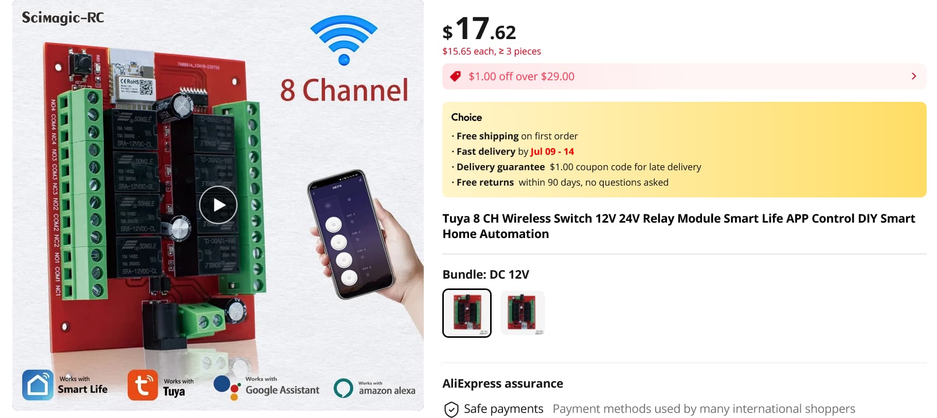

Do you mean something like this?
I experimented with a similar Tuya I/O board some time ago , unfortunately I found these devices to be very chatty… :slightly_frowning_face:
