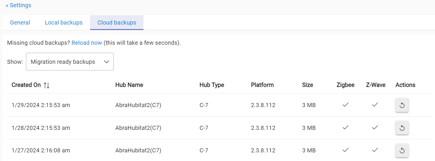

If you are running the latest Beta Firmware on you hubs, and if you have an active "Hub Protect" subscription on your existing C8 hub, then you can easily Migrate to the C8 Pro today. I just went through that process yesterday without any issues.
However, the Hubitat Team is still working on enabling the free Hub Migration backup feature on the C8 hub, to allow one to migrate to the C8 Pro without requiring a Hub Protect subscription on the old C8. I believe this will behave just like it does on the C5 and C7 hubs, where this is currently an option as shown below.
This option is currently not available on a C8 hub. But, we've been told it is being worked on.
Again, to use Hub Protect today, you will need to be enrolled in the Hubitat Beta for both hubs.

My C8 has Hub protect and I have daily backups.
However, C8-Pro does not have Hub Protect, and it cannot see my C8 backups, it can only see my C7 backups:
C8 is on 2.3.8.112 (beta), C8-Pro is on 2.3.7.145.
Upgrade the C8 Pro to 2.3.8.112. That'll let you see the Cloud Backups from your C8, and perform a Migration Restore.

Yep, I was in same boat until Bryan got my Pro enrolled in the Beta -- after updating it, I could finally get to the desired cloud backups. But then ran into the ZW issue I mentioned in another post.
