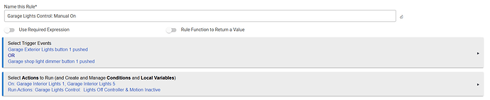

    • The screenshot of the rule that turns the lights on is below. The rule consists of 2 actions and the first action turns the lights on.

The rule that is being executed:
